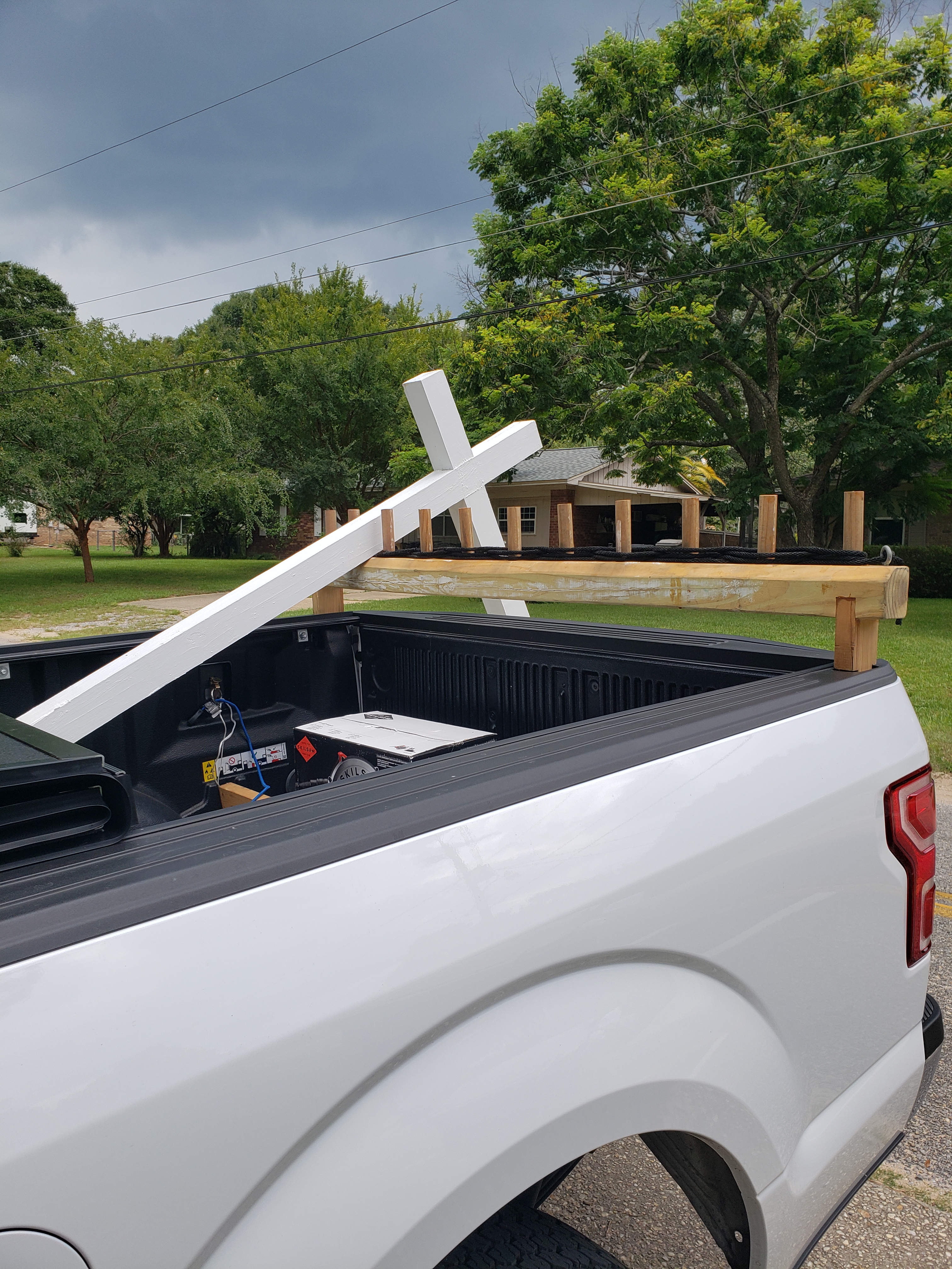

We have 3 2019 f150 crew cab trucks with the 6 foot or so bed. They are pre assembled posts. We built a cross member that nests in the bed pocket stakes that keep the posts off the tailgate but we still are unable to drop the tailgate so it's a bit of a pain to access the space under the posts. Just thought someone might have a better setup.

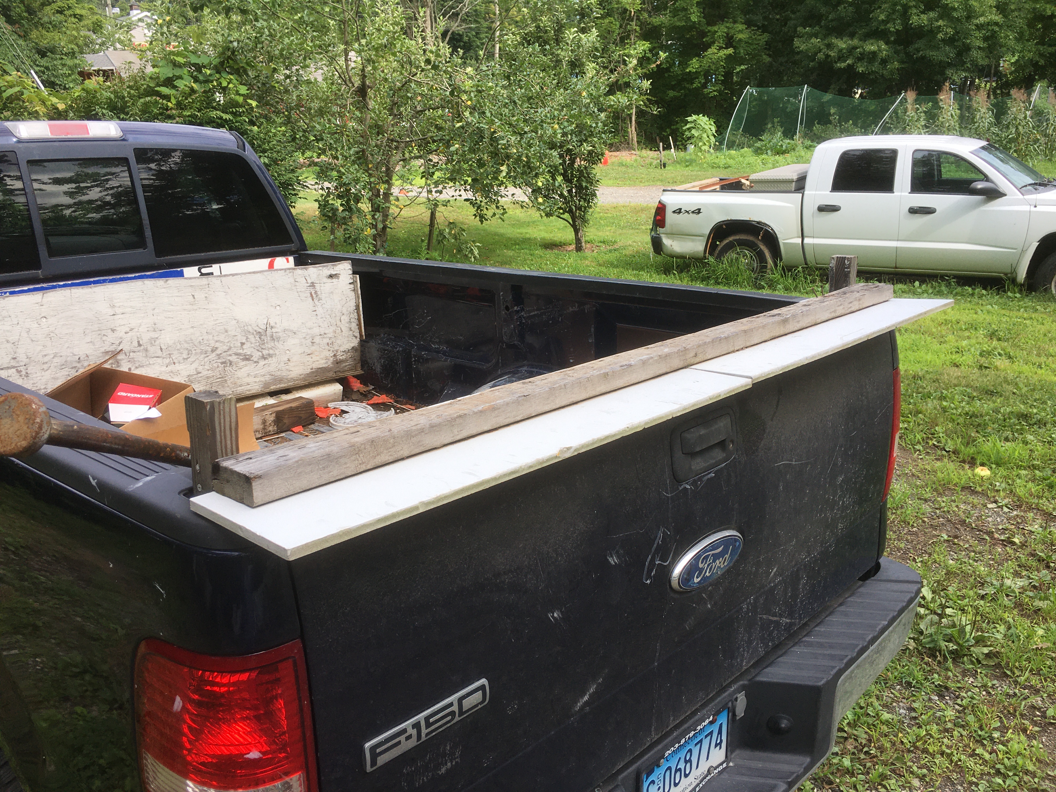

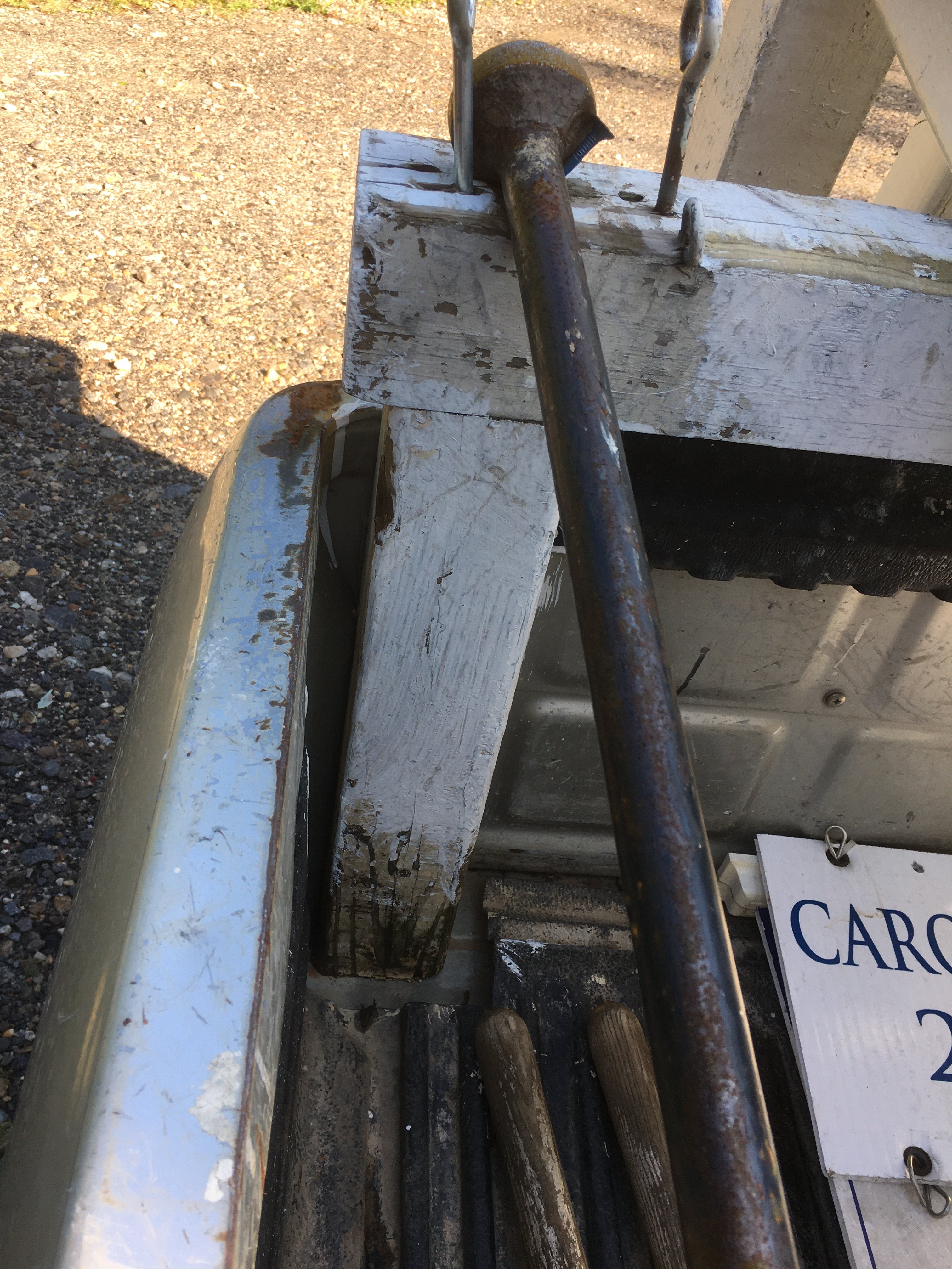

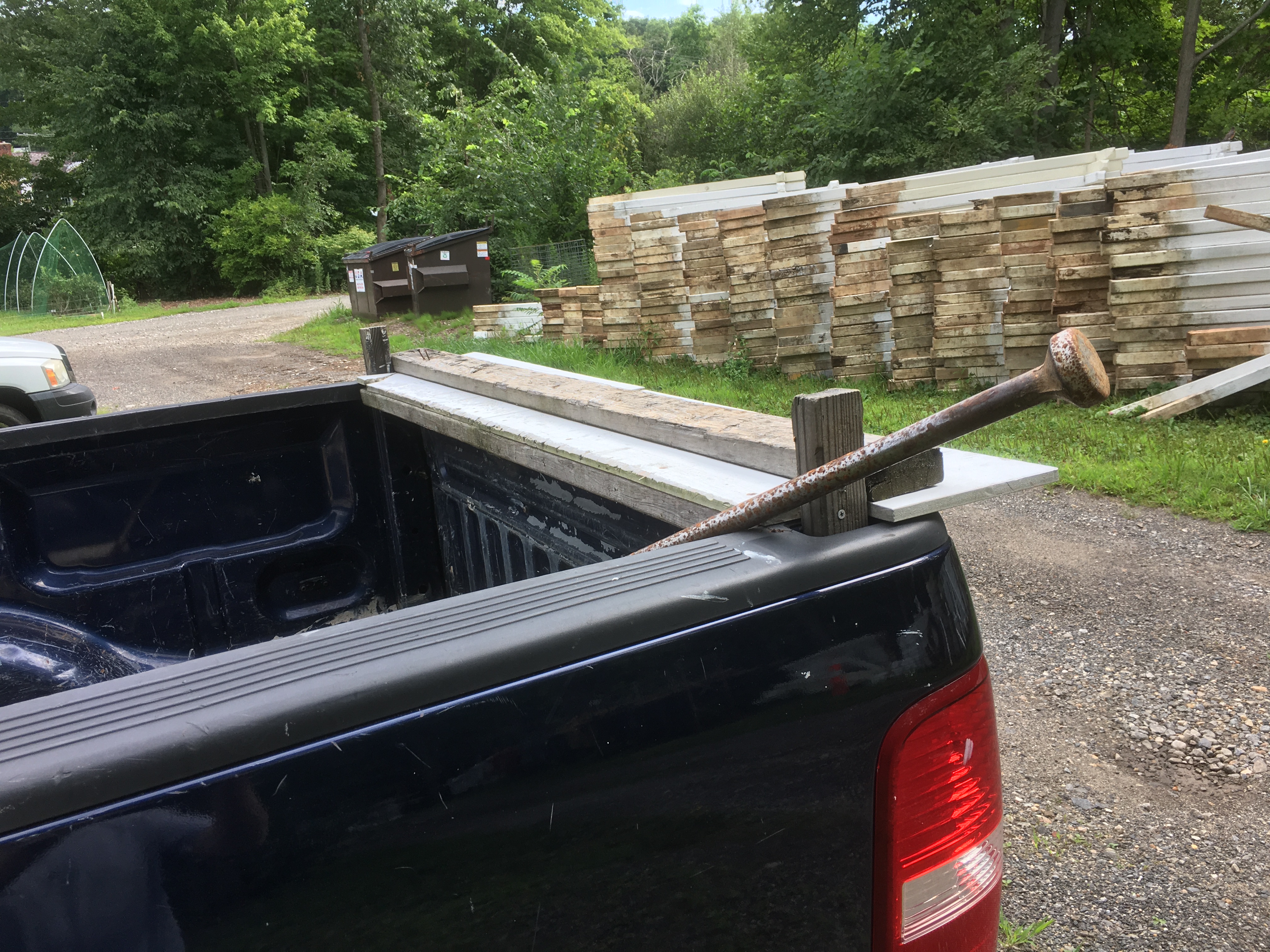

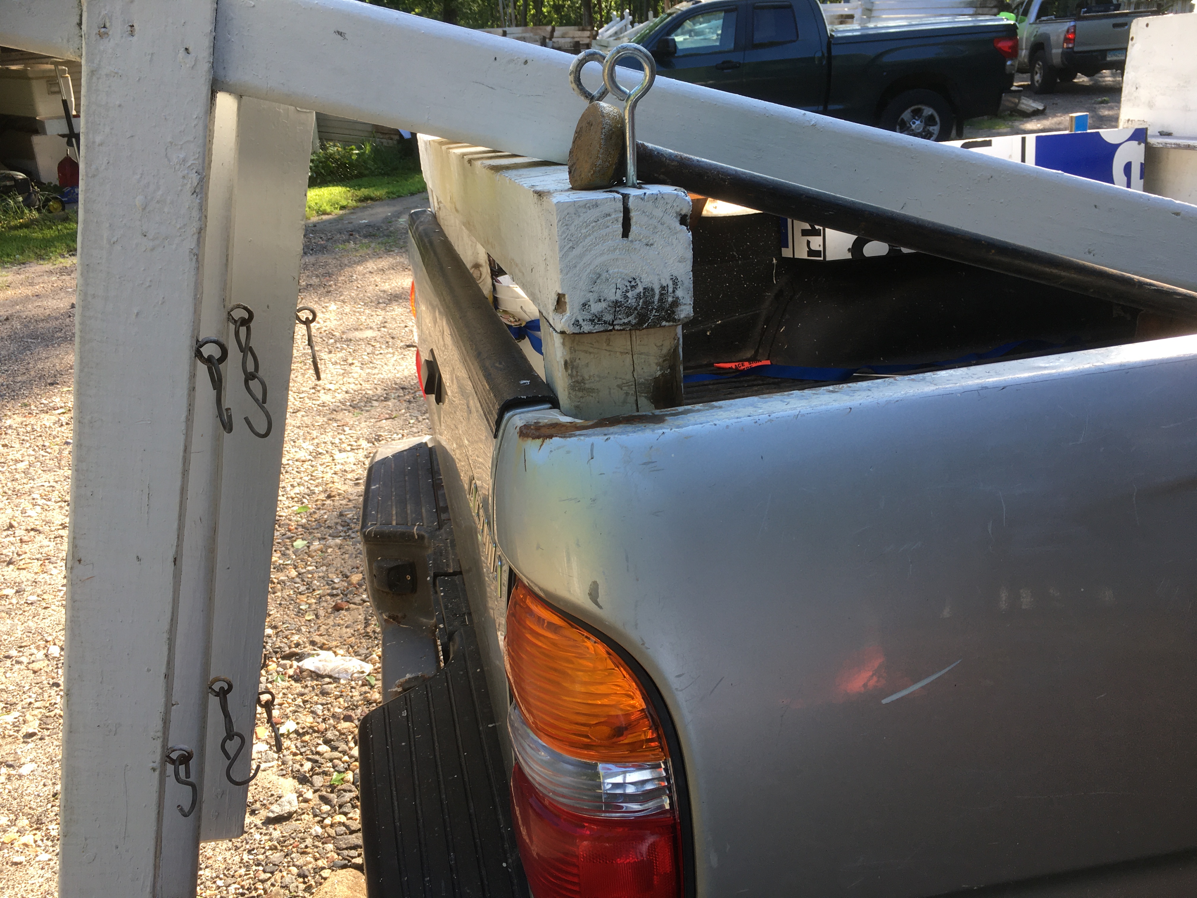

chester215
Just call me Chester.
Full sized trucks are easy if they have the pockets for the stakes on the top rail of the bed.
We cut the pallet dividers from pallets of 4x4's down to fit inside the pockets and stick up 3-4" past the top of the cross piece so the posts don't slide past the end of the bed. Cut a piece of plywood for the bottom and have it stick out past the back of the tailgate so the posts don't hit the tailgate. Then a 2x4 or 4x4 on the top screwed to the pieces coming out of the bed pockets and the plywood.
For small pick up trucks, remove the tail lights and lag bolt 2 4x4's vertically to the inside of the bed. Make sure the tailgate closes and cut the pieces long enough so the top of them is past the top of the bed and the bottom of the 4x4 rests on the bed. The length of the uprights will depend on the configuration of the truck. a 4x4 will be shorter than a 4x2 so you will need to test fit a full sized post to see if it will scrape on the ground, even when going up a steep driveway.
Then lag bolt a 4x4 across the top of the two uprights. You should put something to stop the posts from sliding past the end of the vertical piece, we use a large eye screw because we have them.
For the smaller pick ups you will need something from keeping the end of the post in the bed from popping up when on the road. You can use several ways we do this. One is with a tool box mounted to the front of the bed. Another is to put a cross piece somewhere screwed to the top of the bed. the last way we do this is to have a box for the panels in the front of the bed with 2- 4x4 spacers stacked underneath mounted to the bed. We also have generator racks from the past 20 years of trying different things that mount in the bed (one is pictured with a power inverter & deep cycle battery mounted in a box) that hold the front of the posts down.
