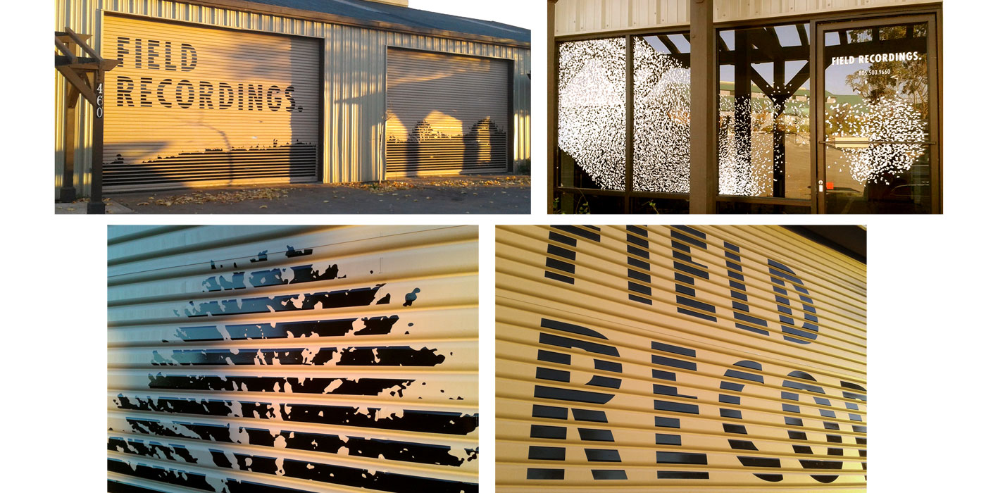

I've worked on a few corrugated metal buildings. In the end, painting it has a much better life. Here is a photo of work we did on horizontal grooves with the artwork cutout in between each groove. It took forever to install, but with a graphic large scale enough it has a really cool effect. We used high performance cast black 3M vinyl to get the most life out of it. The building is in full sun most of the day with drastic temperature changes throughout the year (10 degrees in the winter and up to 115 in the summer). It's been in place about 4 years now and still looks really good.
