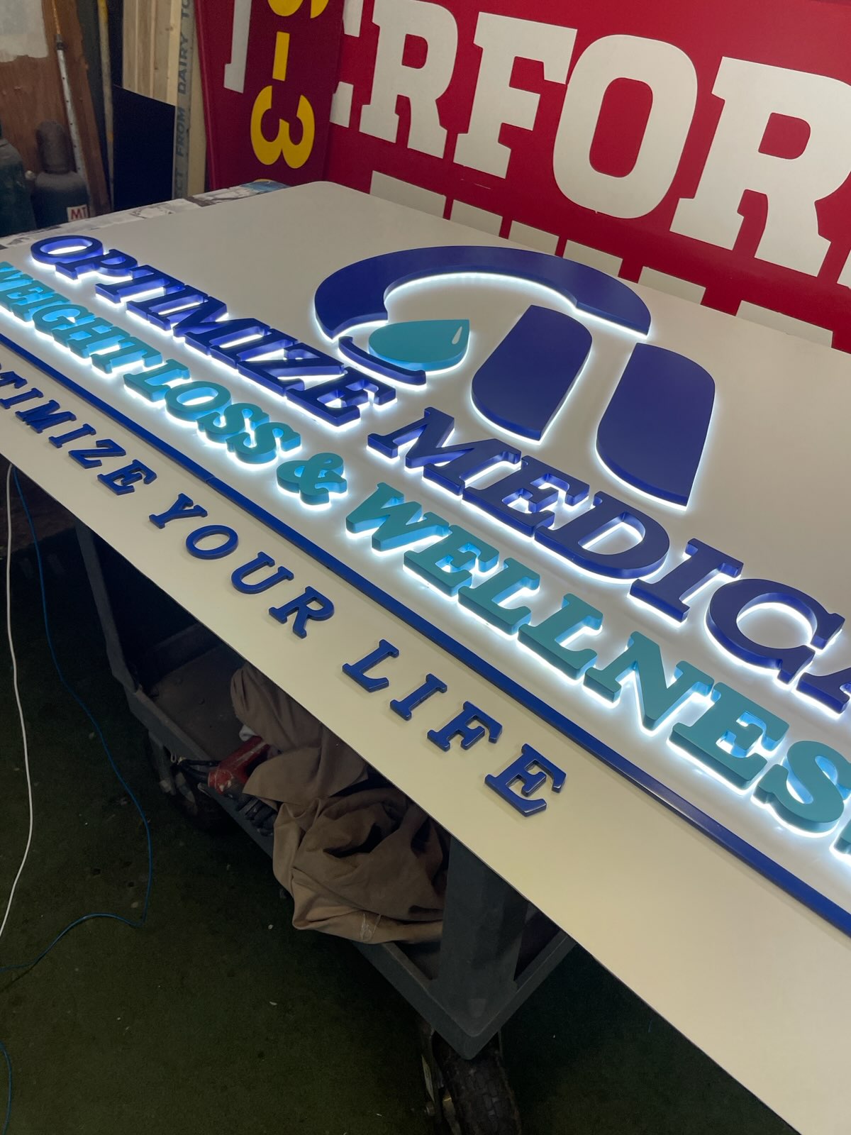

A client called and asked for help on a lighted sign they bought from etsy or pinterest possibly, she couldnt remember. It was their logo done with metal faces that were tapped for transulcent bottoms and the insides were led flex taped to inside of circumference of letters, damn well built and heavy, top logo about 10" tall 2nd cop approx 4" and 3rd copy 2.5" tall, very intricate. The pattern they sent was printed on a banner material, which was weird But it didnt have the hole indicators for the power lines which was a guessing game for the installer. After she purchased she said she called them about this or that and the number was discconected and there was no record of the purchase
her husband installed them on sheetrock wall and I admired the tenacity of him doing that as they were stud mounted with the flimsy banner pattern. Problem is it had wires and there was no way to hide wires so they took it all down and I placed them on a max metal board with silcone and stand offs wired it all up and it much better now.
My question is are these companies that is selling this stuff creating accounts and selling a few of these and then deleting thier acoounts to open a new one to keep from having to do tech support? The quality was top notch, these things are waterproof and they are heavy! It came with a power suplly that has a little fan on it, I told them to shut these lights off when not it use!

No idea about etsy or pinterest, but that's a lot of individual letters to wire up in a wall. Good job putting them on ACM. Looks like quality.

These are foam with acrylic backs that don't properly align. HDU is not rated as an enclosure, so you have to get ip67+ leds that could be rated as a 'fixture' in the first place, the foam is a decorative element. Curious if they just glued the stuff together, as mounting foam through clear backs with no face fasteners is pretty challenging.

nope they are metal letters with polycard backs that are drilled and tapped into the metal, this is like gemini quality stuff here
