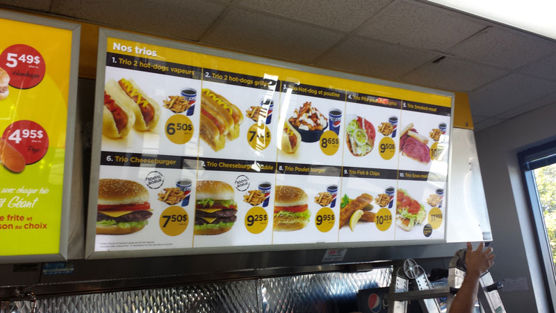

I do alot of menu. I do my own LED backlit with snap frame (only 5/8in tick). I also do just the snap frame if the customer do not want the light.
bigben
Not a newbie
Man those are really nice!! All custom made? Do you have more details? I'm really interested in this! :smile:
:cool1:
I have a division specialize in LED lightning. We custom built LED light box like these. I have different snap frame model and color, we got a 2 years warranty on them. This division do not sell to end customer directly, we sell to signshop, marketing box, designer, etc.
I have a pdf catalog in french, I got the english version somewhere if I can find it. Here is some pictures of previous install we've made via my sign company.
