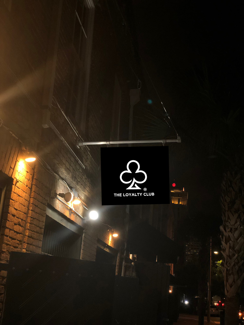

Please see the attached photo for reference of size. The sign measures 30" x 30".
We are not looking to save money on materials but rather save time i.e. painting, prep, treating.
The finished look of laser cut acrylic has a modern look that many of our customers are interested in.
We simply want to make sure it is safe to attach and hang from a bracket despite its weight. If so any hardware recommendations are appreciated.
We do not like using PVC because it bows overtime with sun exposure.

I wouldn't use acrylic. If you're going to have a sign hanging over an area with foot traffic, it's too risky. A piece of acrylic in a monument is one thing. UV and temperature exposure creating micro cracks aren't a big deal if the acrylic becomes brittle in a frame, but when it's bearing it's own weight, it's another story. A 30" x 30" piece of .5" acrylic is heavy and could seriously hurt someone when (not if) it fails. I'm not sure what kind of temperature ranges you experience where you are, but UV exposure and constant expansion and contraction of the acrylic is going to weaken it too much.
I'd stick with a material that is better for outdoor usage and can be reliably mounted. I know you're trying to save time, but there are reasons people use stuff like ACM and HDU for outdoor signage instead of acrylic.

I believe they were talking about cutting dimensional letters on a laser (and maybe the back) and mounting them to the piece of acrylic with weld or tape.

I'd say Colorcore would work for you, in that case. Lasts 20 years, weatherproof, black, white, no issues with painting. Has "substance". Should be able to sell that.
If you want it shiny that's another thing.
I would build a solid metal frame, first. Gives you attachment points and holds the pieces together.
I'd have a layer of black PVC, sandwiched between 2 layers of glass, with 2nd surface white vinyl application. This would last a good long time as well.
Make sure you're attaching to the frame, since PVC doesn't hold screws for sh*t and that's a heavy MF sign. But it would be awesome.
visual800
I would use 1/4" ACM with 1/2" pvc routed letters OR cut acrylic letters. I dont like acrylic outside but think it would be fine for this lettering. I would paint ACM with latex and silicone the lettering to it. You wont have any issues, also do not allow this sign to swing.
