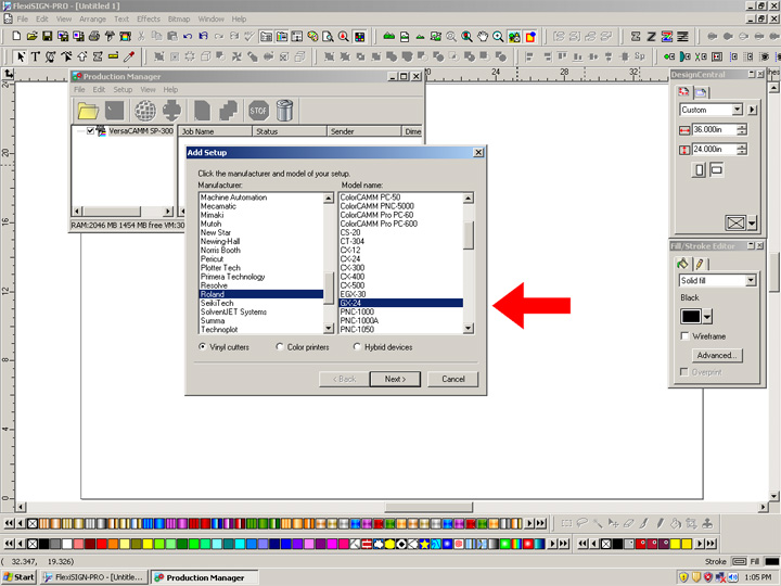

So I guess there is no way to work the gx-24 with flexi sign 8
The GX-24 on Flexi 8 is not the issue. Flexi 8 on Windows 7 is your issue I believe.
Here's a screen shot of Flexi 8.1 and there is the driver for your GX-24.
