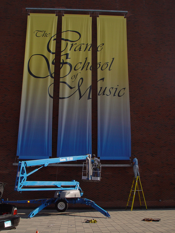

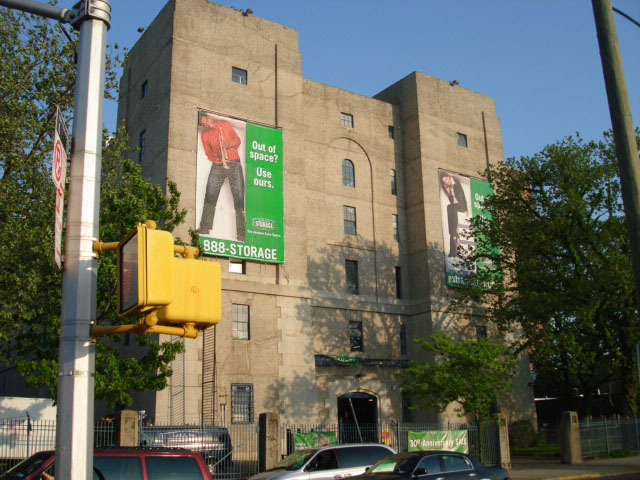

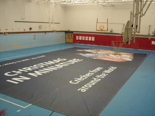

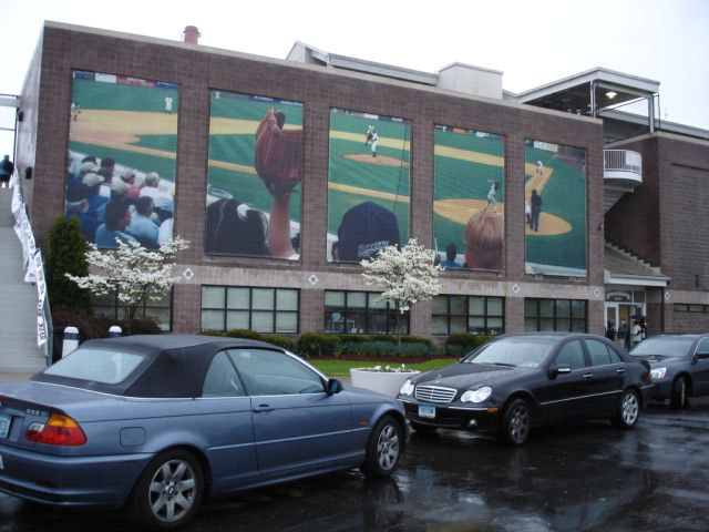

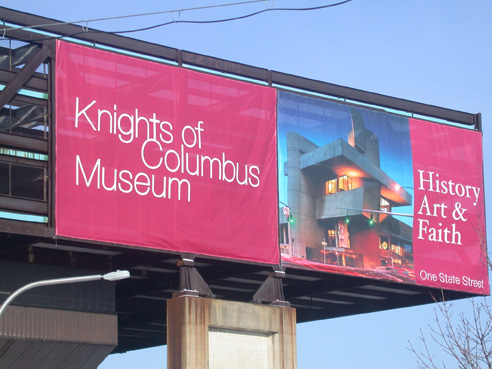

Never heard of mesh looking "washed out" No way to even tell difference between mesh and banner. No need for any different profiles other than whatever you use for banner or double passes. If anything mesh requires less ink density and should be able run at machines fastest speed with no issues.
Can you tell the difference from the attached of which is mesh and which is banner? All were run in billboard mode at an average of 1500 s/f an hour

The baseball scene was perfectly separated. We have done a few of our own. Small scale of course. But I've seen a very bad one at a Trump hotel in New Roc NY. I laugh every-time I see it. The scene is people enjoy drinks at the bar but the woman's nose was never cut well on second pane that she has a very long nose. I'll post next time I go by it!
But you guys know what your doing!

aye, i hate when people print tiles with spacing, but don't add the spacing to their artwork.
i'd much rather "look through a window pane" than "force my eyes to piece together a puzzle"
