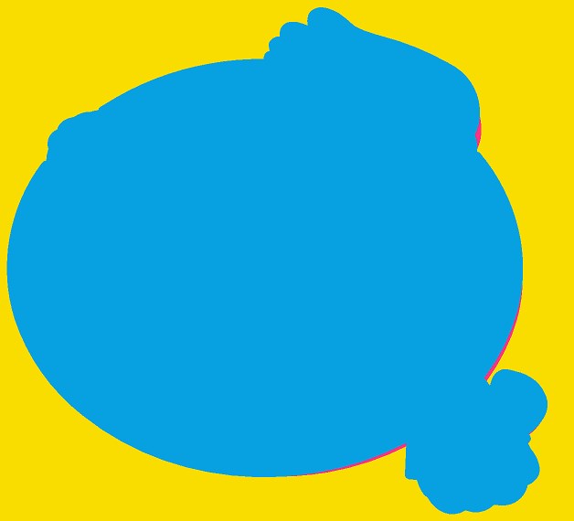

A customer wants to us to print a replacement decal since the one on his sign faded but he doesn't want us to remove the previous decal. We are going to make it slightly larger to cover up the old decal but some areas still stick out. We are trying to figure out if there is a term for what this is called to explain to the customer.. Here is an example of what I'm talking about. Pink is previous decal and the blue is the new and slightly larger one that we are trying to line up.

If you're using Illustrator, you want to use the, "Offset Path" function. Instead of scaling it actually moves the path outward however far you want it to go. I assume Corel and other design software have something similar.

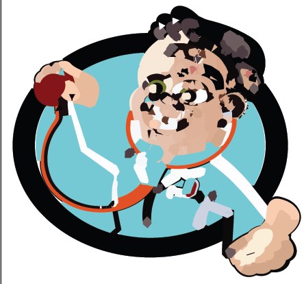

Thanks, you two! As for the offset path I think the logo has too many things going on with it because it looks scary now :p
It does give me an obvious idea that we should just a make larger outline instead of scaling the design.

Haha yeah usually I will copy and paste in front, offset path, merge all the elements, and then send to back. Then you can make it whatever color you want to match the image.
That cartoon needs a dentist.
I'd just use the offset tool and enlarge it til it fully covers.

Or, (in Illustrator for Windows) make the whole graphic into a group (CTRL-G).
Click the grouped image. CTRL-C to copy it. CTRL-3 to hide it. Then CTRL-SHIFT-V to paste back into place.
Click the image again. Go to PATHFINDER from the WINDOW menu to open the Pathfinder panel.
With the image still selected, click (in Pathfinder) the MERGE icon, then click the UNITE icon a few times (for good measure).
Now your logo image should be one solid shape. Use the menu item OBJECT / PATH / PATH OFFSET function here to offset the path as needed.
Hit CTRL-ALT-3 to Unhide the original image. It's probably behind your newly-offset path, so click that and send it to the back.
Scale the original image as needed. Done.
Sounds like a lot, but it'll probably take 5-15 seconds.

Customer doesn't want to pay extra for us to remove the old decal nor does he want us to apply the new one. We wanted to make it as easy as possible for the customer if he decides to cover up the other one.
