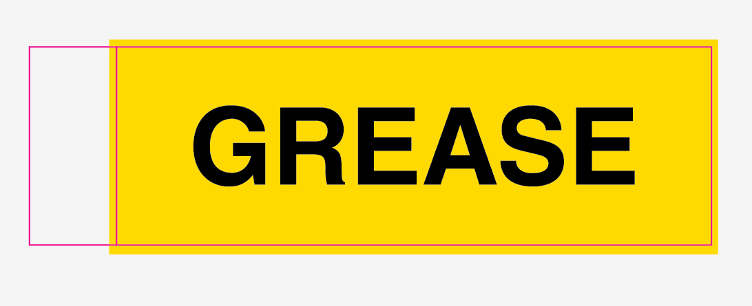

Owen Signcraft
I know this is an old thread but we use this method for "crack and peel" decals. If you have the room just add a kiss-cut tab to the graphic. Bend and peel. Works just like a back-slit but on the face.
