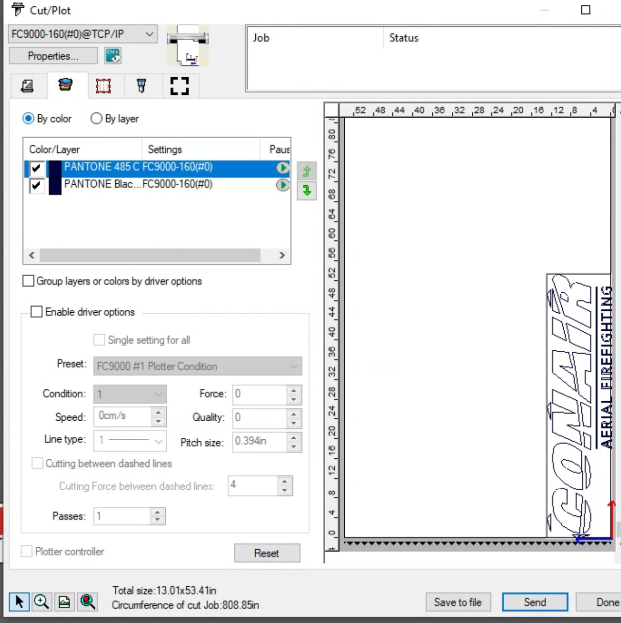

CM4 you can sort by color, or by cut.
Click the Layering tab... it'll be default on layers. Click "By color" And you can select which color you want to cut. It uses whatever the spot name is...so if you have it as "Cutcontour" then it'll show up here.
