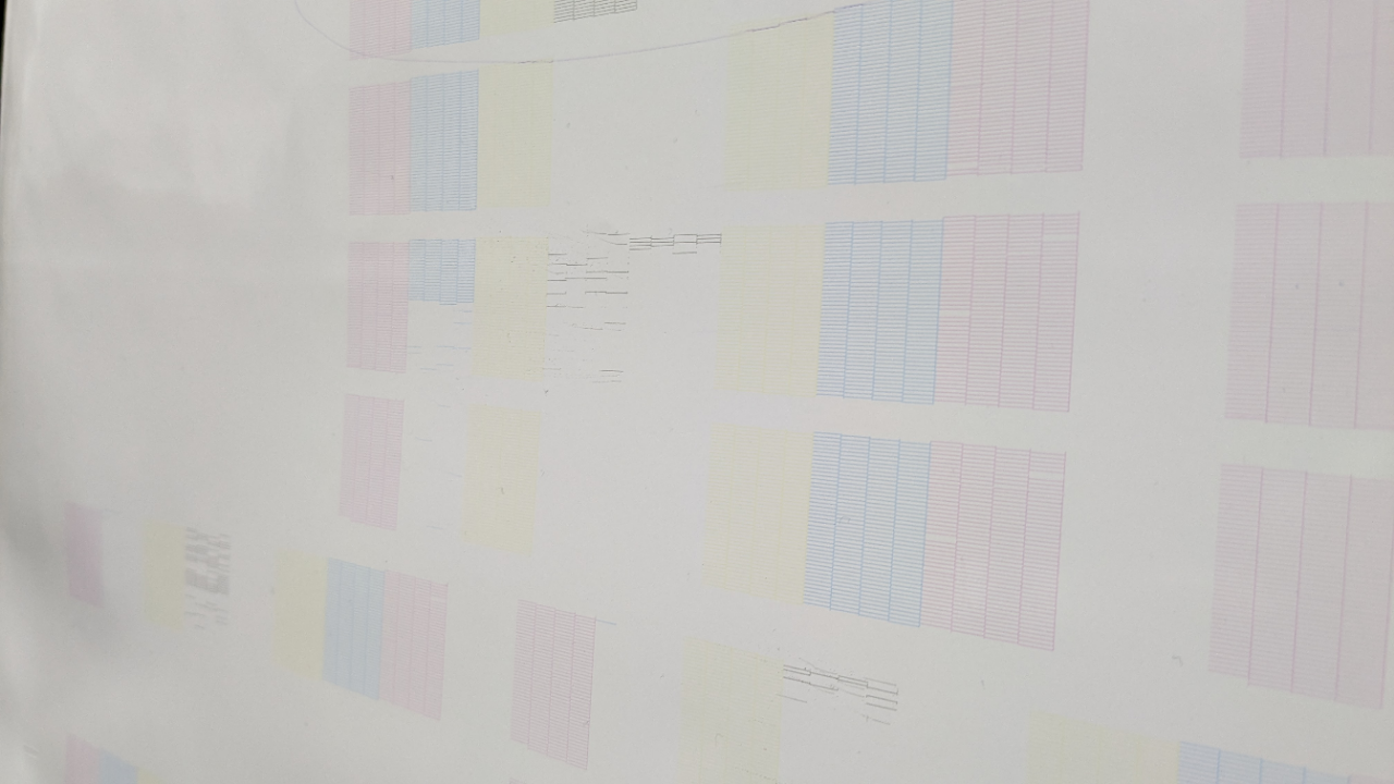

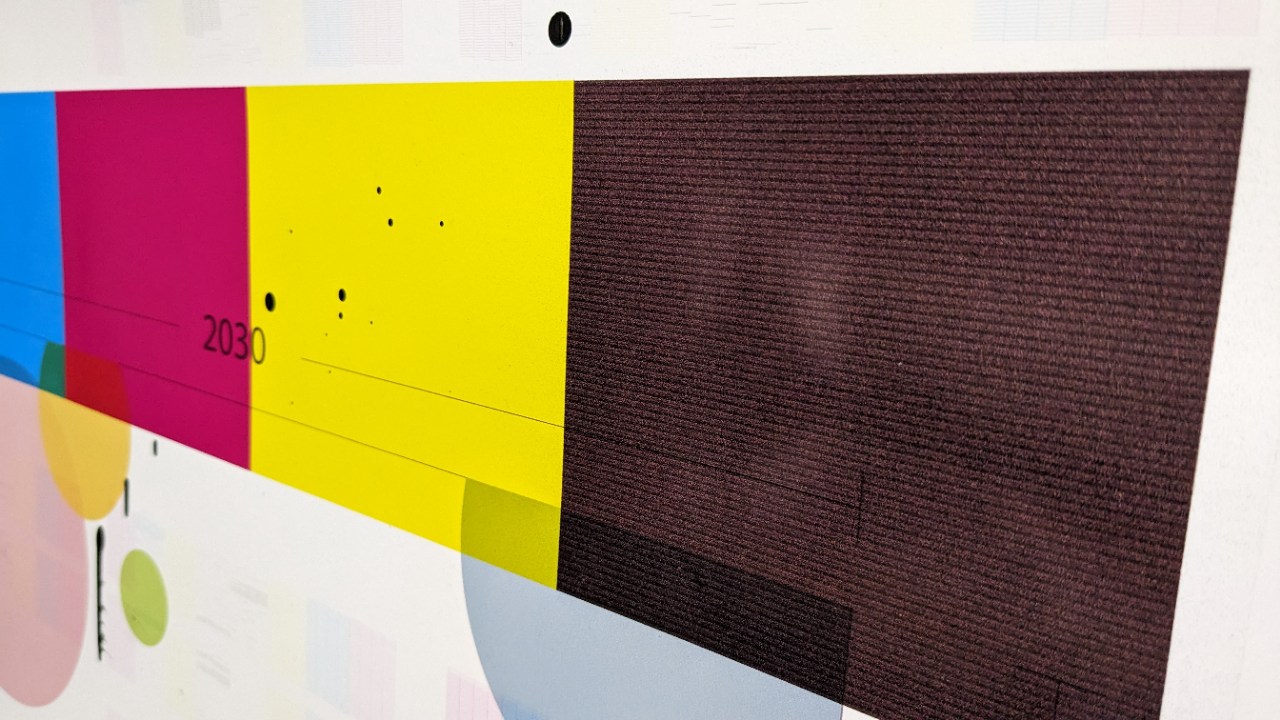

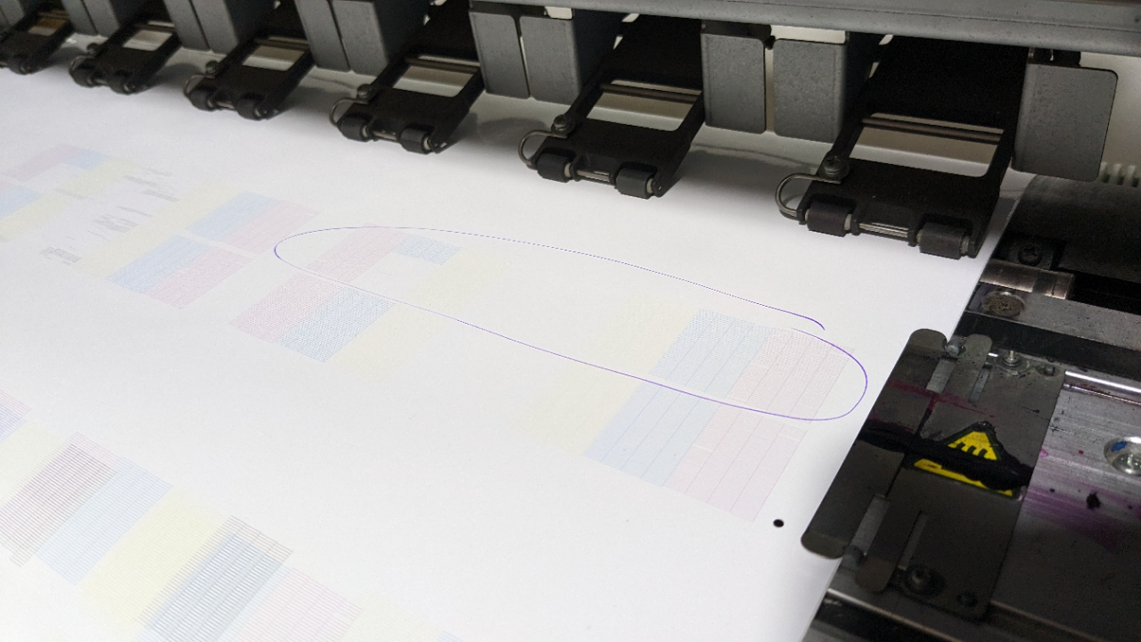

from the images below, and some info, can someone please advise what is my issue here?

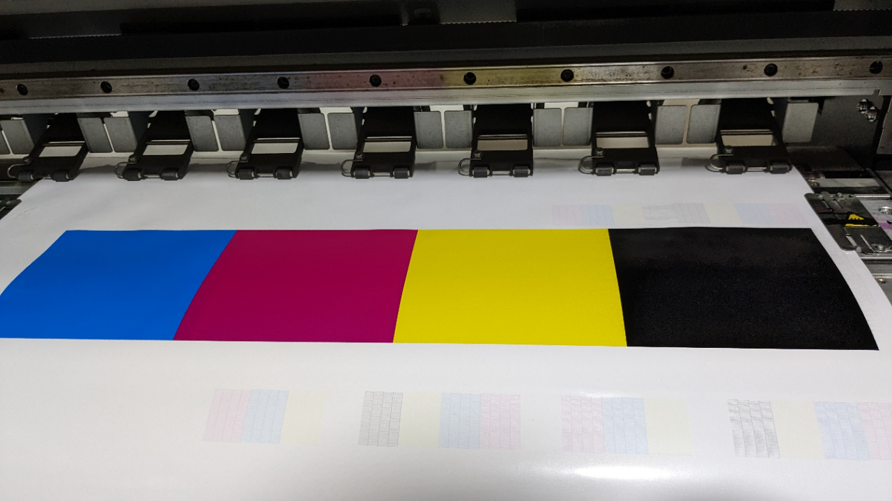

Running JV33 on dual CMYK
so... after printing about 1m (3 + feet) my K is completely dropping out.
Currently I'm doing some hard cleans in between each print and it seems to revive one K channel, and not the other.
But, when I do a test draw, it flips between each channel.
some images below:

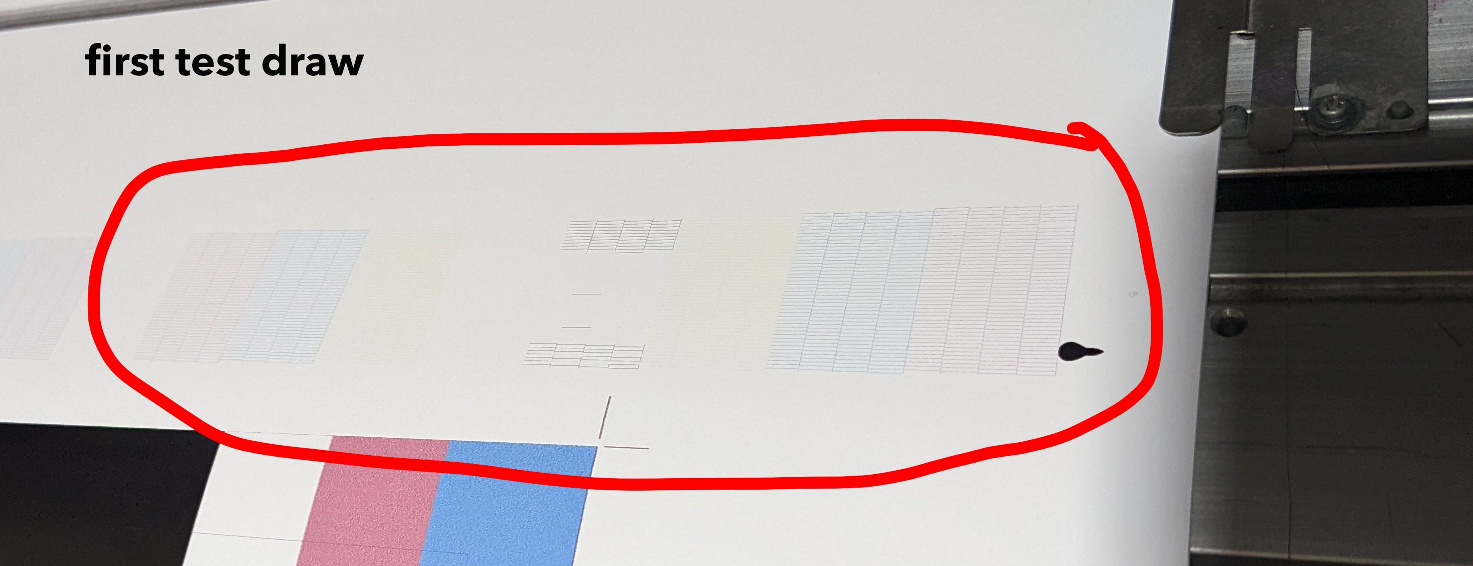

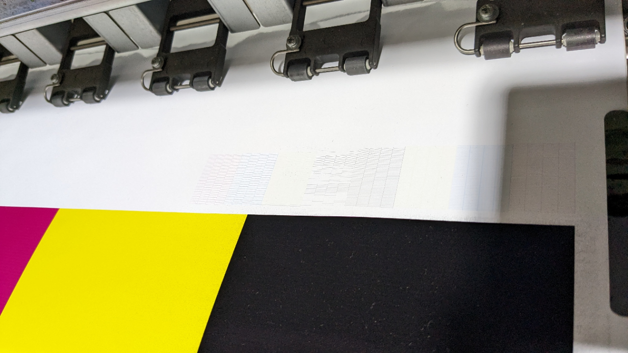

This one shows nozzles on the right K channel

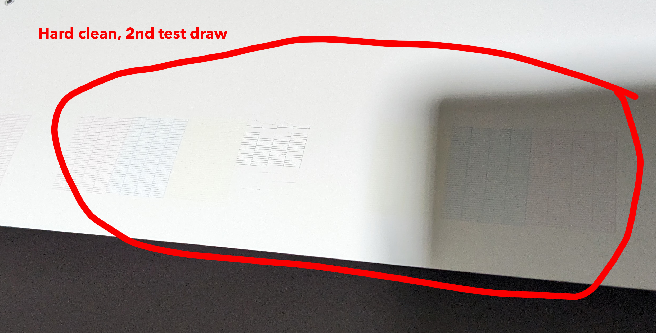

second hard clean, nozzles appear on the left channel, no right channel.

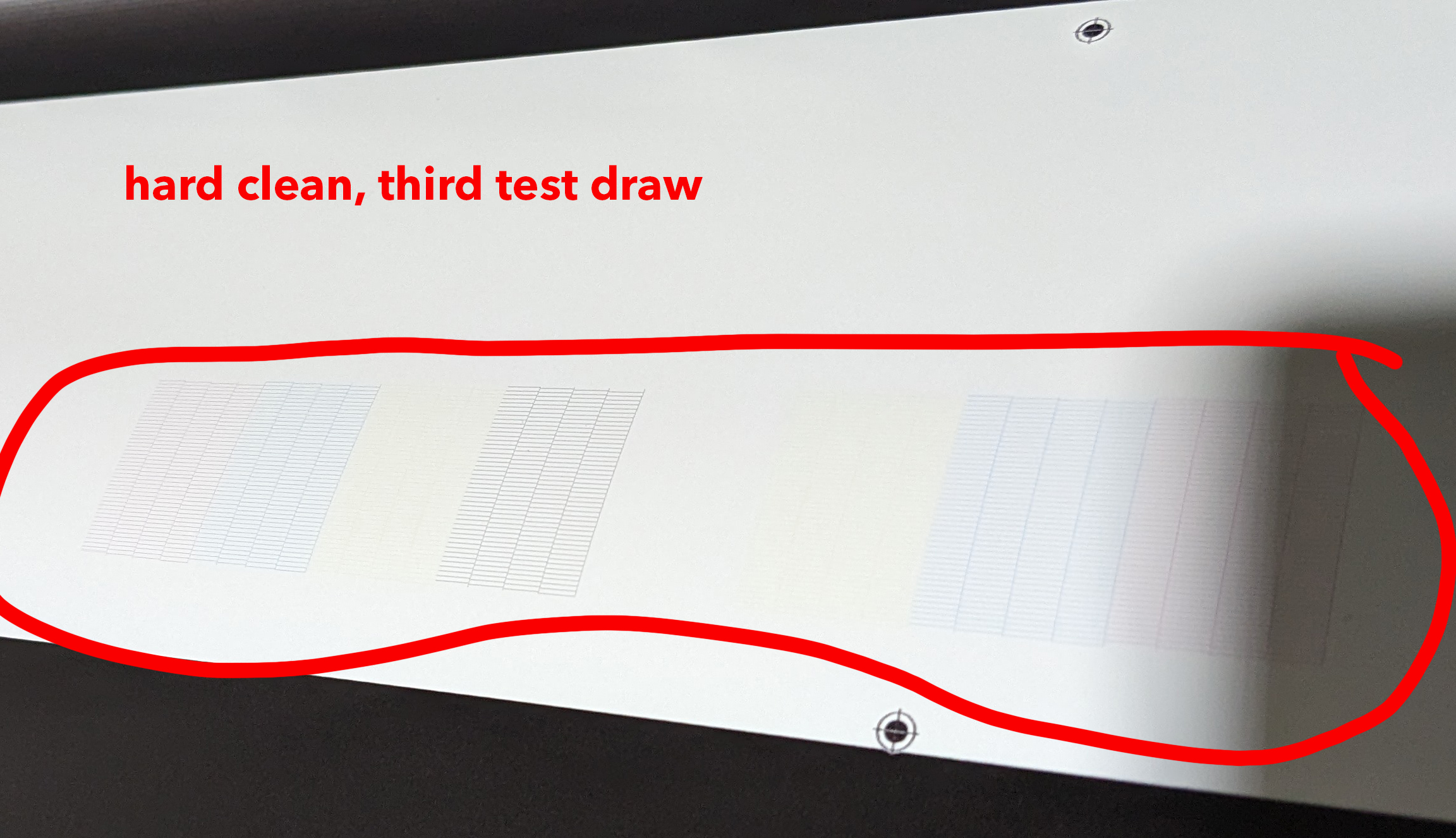

Third clean, K left is back, no right.
I do this for every metre of print.
Is this the capping station that needs to be replaced?

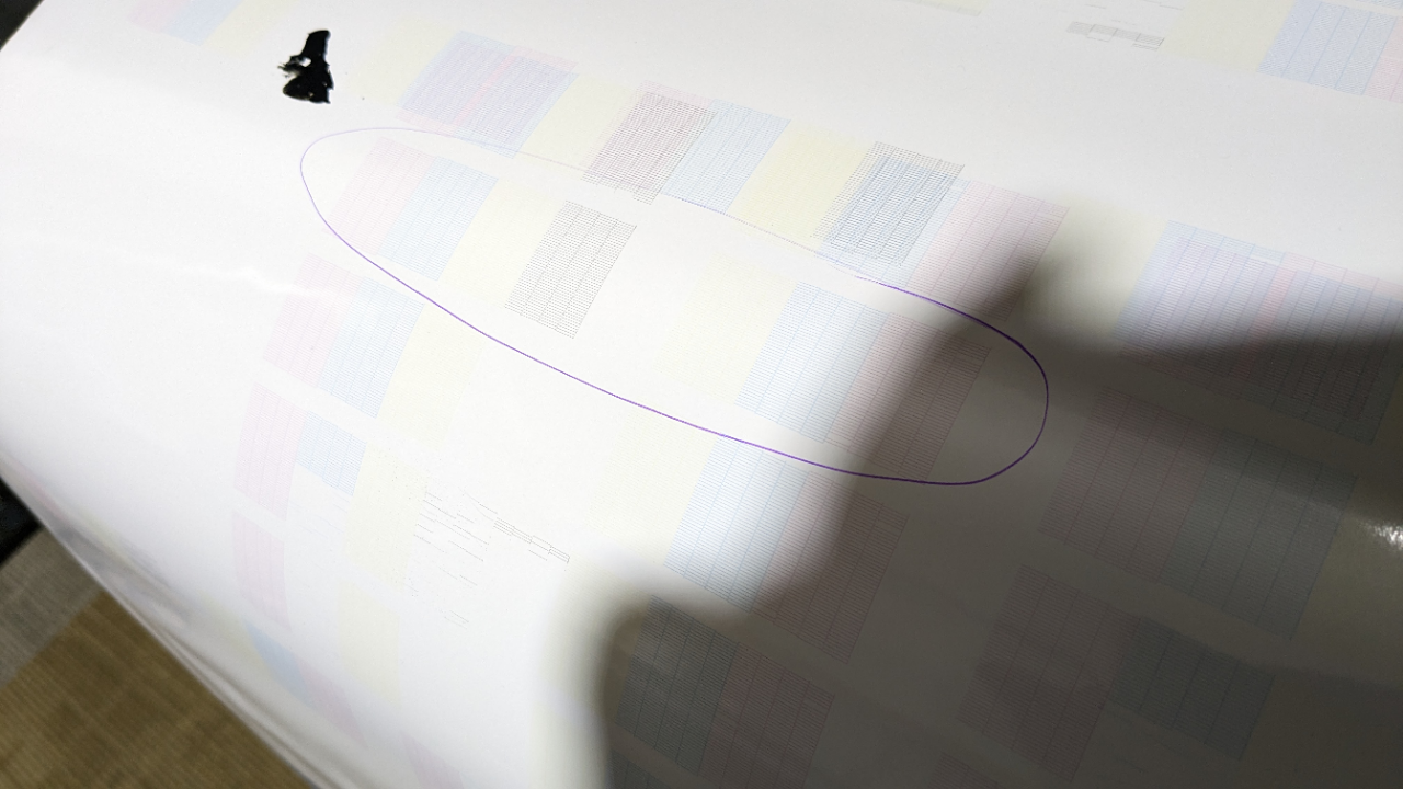

I'm also occasionally getting the Cyan chanel dropping hapf a head in the nozzle test. Not every time, but occasionally.

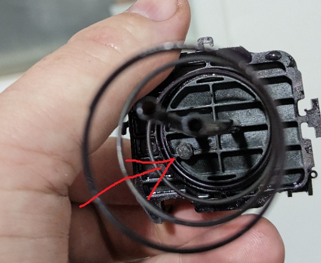

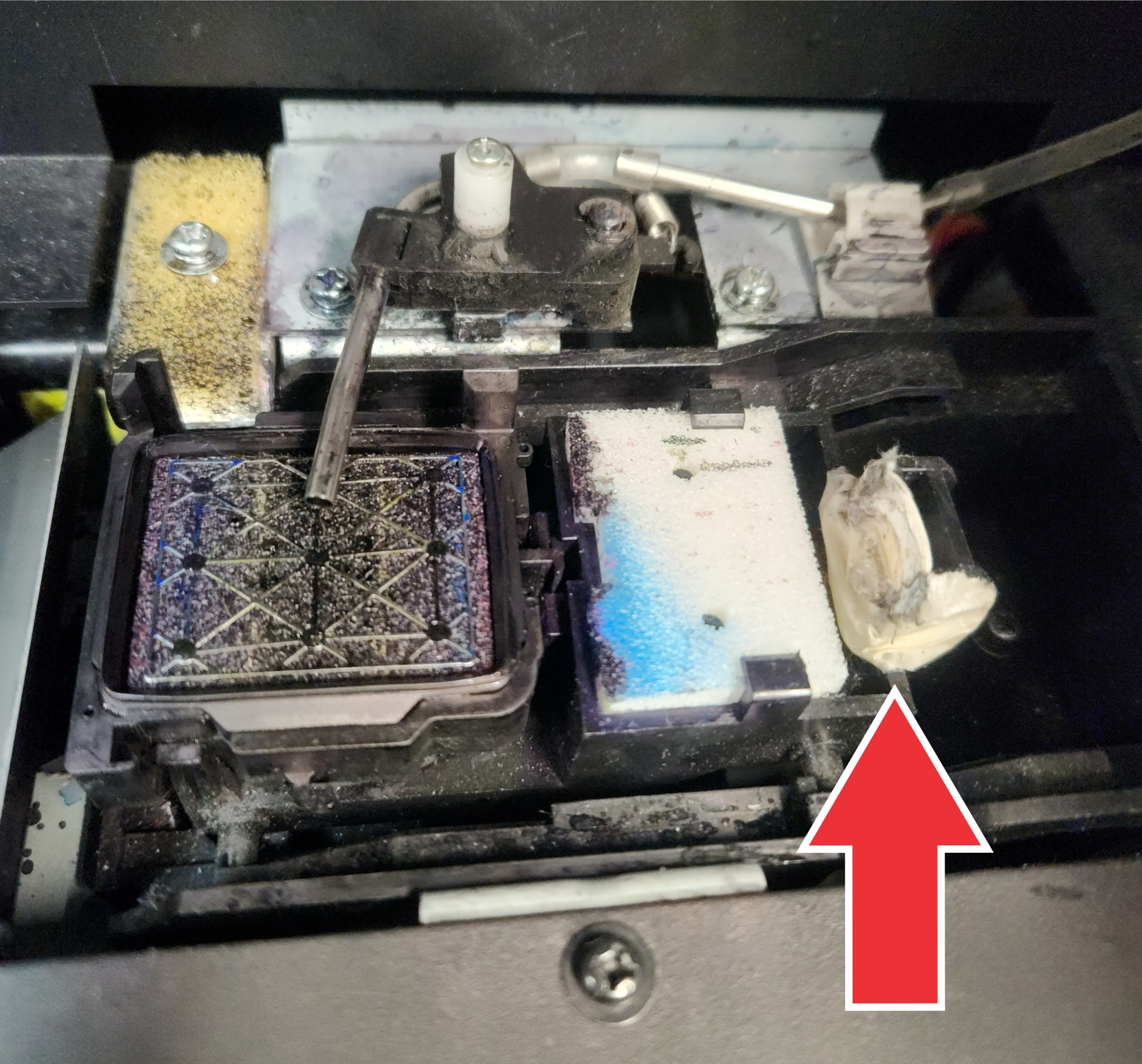

Here's an update.

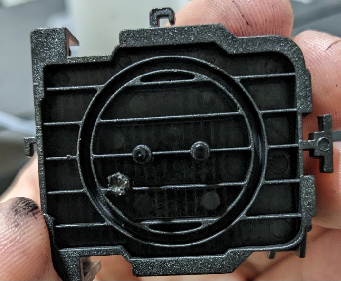

I inspected the old cap top and new cap top.
The old one had three hose outlets, but one was sealed.
the new one had this open. I sealed it with a soldering iron.
So now, I have all new dampers, and new cap top.
All the colours are back except the Kay, again, it's dropping out.
I replaced the new Kay dampers with the old existing ones (yellow). But I washed out the dampers with solution and refilled it with black.
Either with or without the new dampers, the issue still remains. Kay is hit and miss and the left cyan channel drops out occasionally
So what next?

I would make sure your print head is lining up correctly with the cap station. When I first replaced my cap station, I started having a similar issue. I had to put a little bumper on the cap station so that the print head would line up correctly when it came back to the home position. You should be able to look at the underside of your print head and make sure the rubber is seal is hitting right where it needs to hit. Mine was slightly off but it was just enough to give me this same issue.

Those odd things usually happen when a broken pin on the captop (where you pinch the dampers) or a shrinked rubber (what joins captop to printhead). Sometimes they break very little... Use a lantern while trying to bend them a little. If are ok, the dont bend anything. If they move just a little, they are broken.
This usually happen because of bad seated tubbing over the dampers.

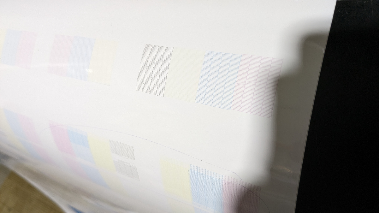

Never say never....
Drained the lines, new wiper, cleaned the head plate...
Nothing to do with the cap or alignments, just neede a good as clean

Here is what I had to do. There was no way that the cap station was going to line up with the print head unless I did something like this. There is no digital way of telling the cap station to move one way or another so this was my manual solution. I used some cardstock and then taped it around this area. When the print head docks, the bumper pushes the print head over just enough to where it now lines up.
I saw it wasn't lining up by removing the service panel on the far left and then sliding the head unit over. You can look up at the print head an see where the suction is happening. I think I put solvent around the edge of the cap station, slid the unit over the cap station and then all the way over to the left to take a peak.
