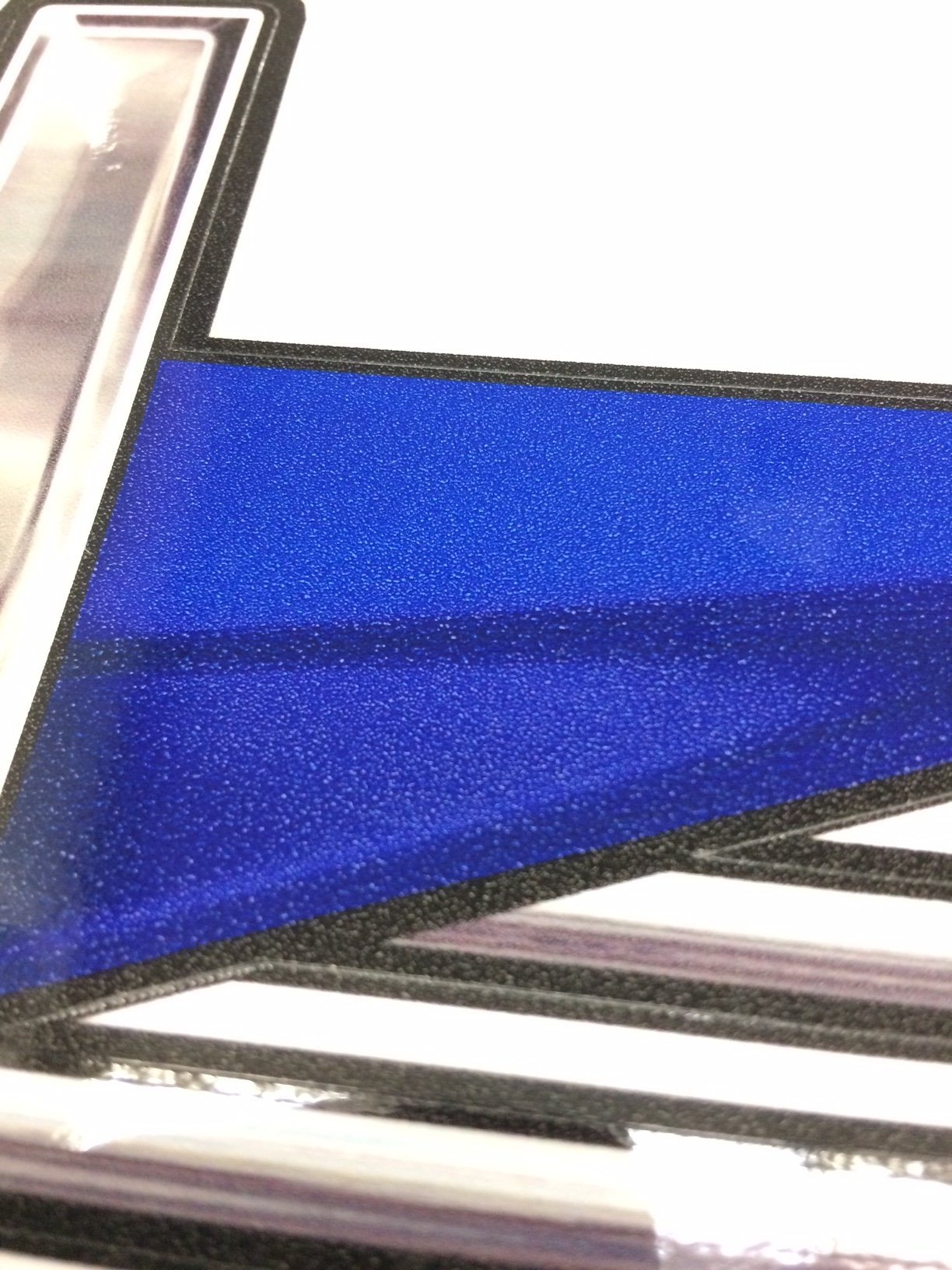

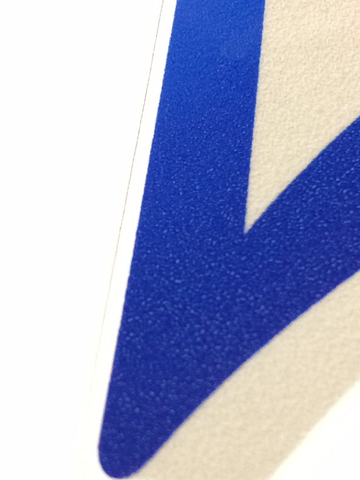

It's my 1st roll of new mC version and colors are not solid... they have white tinny dots everywhere. Previous roll (cV3) with same profile printed nicely.
Here's what it looks like...

BUCKY
It is more than likely the 3M film. We had the same issues with banding and color problems. We purchased 10 rolls from 3 different suppliers of 180 and the older series
materials as well thinking the 180 may just be a bad lot. No changes to the prints with all three different series of 3M films.
Funny thing was our prints on the 3M180mc-120 looked fine. No banding or color issues. Contacted our 3M rep and he had not heard of any such issues or complaints.
So we then called a tech to service our VS540. The tech worked on our machine for 4 hours and could not figure out the cause or solution. He then sends the 3M rep out
for a visit.
I knew from our testing and the other materials we print on that the issue was not in the machine. After 2 hours of running all the 3M films thru the machine in front
of the rep with terrible results I loaded a roll of Avery1105 sample material we have. Out it comes and the prints looked amazing! Better than they ever have.
We used the same test file, with 3M's profile (which I know is not the thing to do...just proving a point). Needless to say he was lost for words.
Do yourself a favor and order the "NEW" 175Cv3.;)

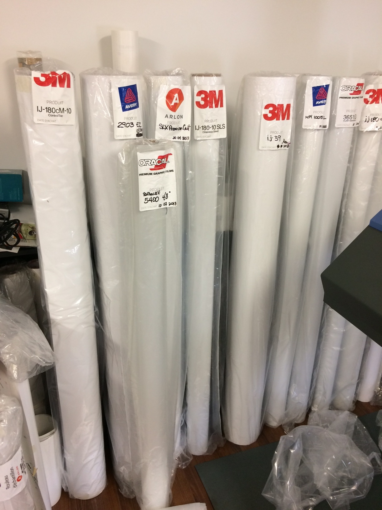

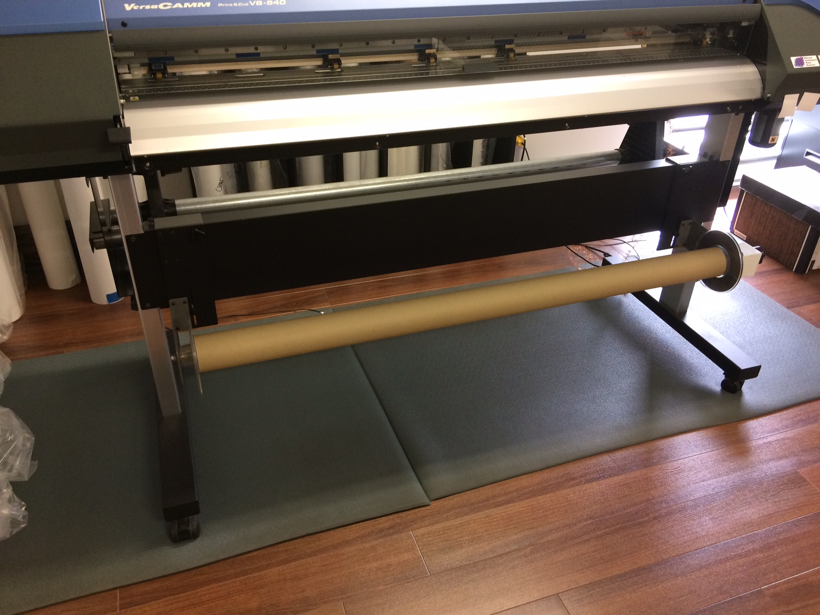

All my rolls are kept in upright position, always in their OEM poly bag, printer is on the mezzanine, far far away from installation bay, sits on anti-static mats in my print room... I've put all the chances on my side for a while... All other films print fine...
one thing you might want to adjust, use the plastic roll holders that comes with your rolls. and place them on the floor. its always a good idea to keep your material up off the floor.

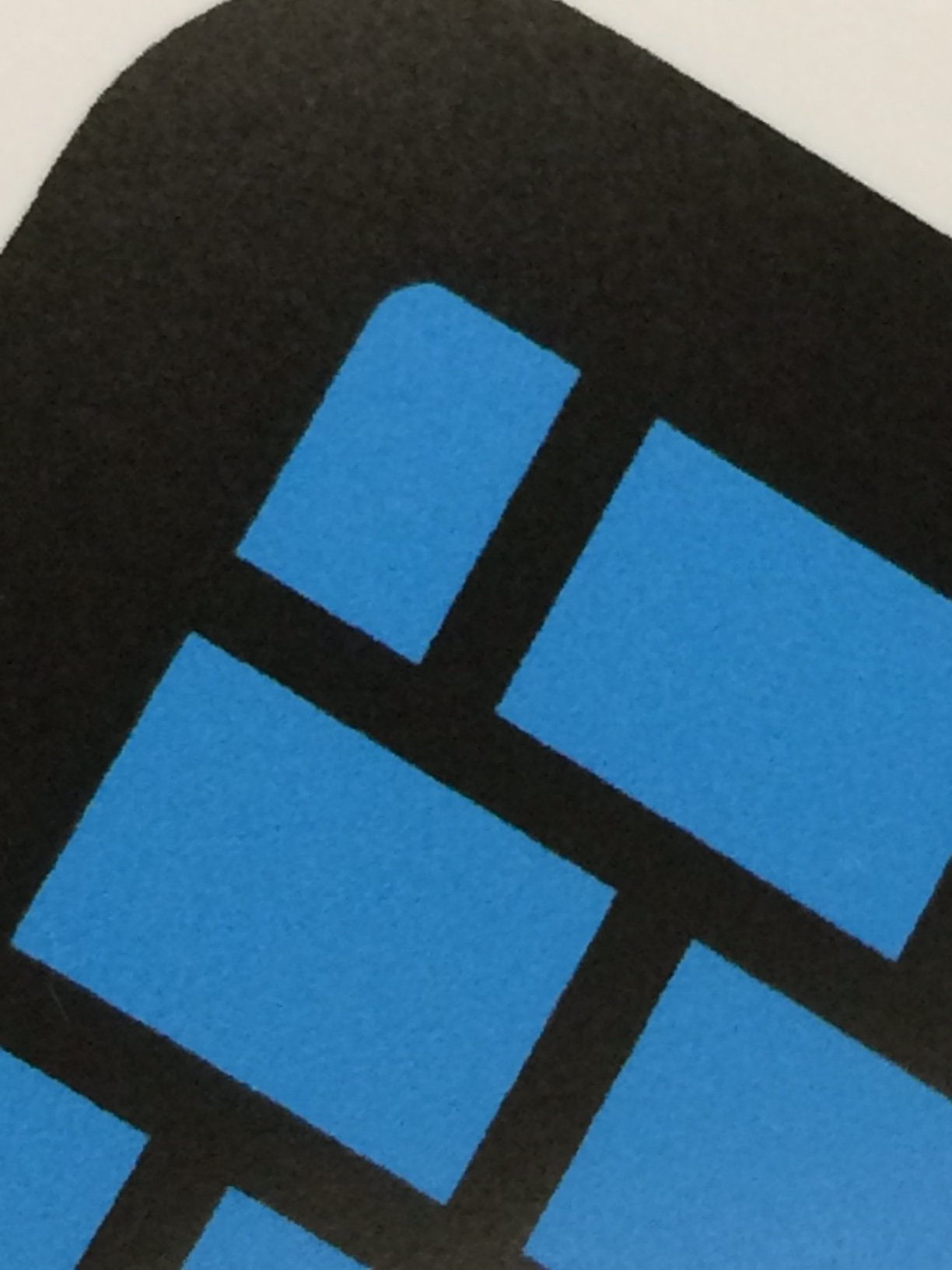

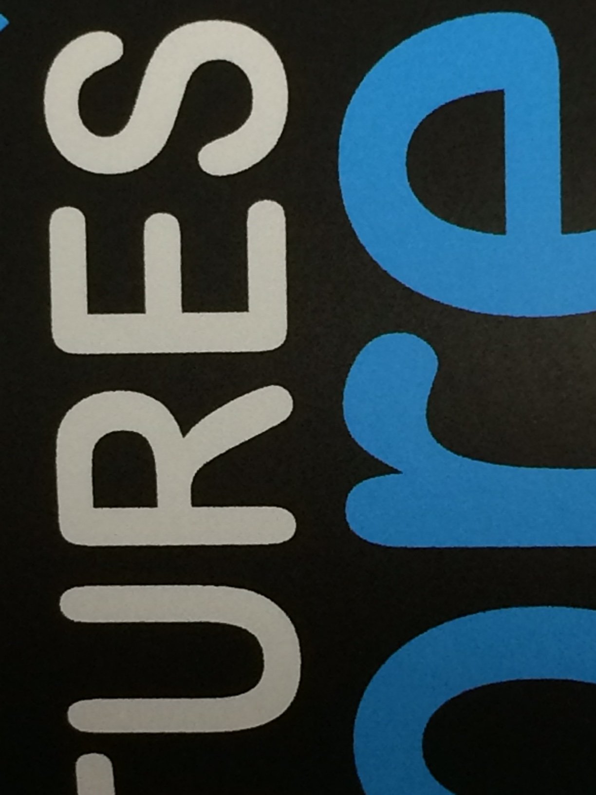

Here's how another roll of 3M prints... I had IJ39 in stock so 'gave it a try. Smooth and solid as expected. I called my supplier and they opened a claim. There's a roll of IJ180Cv3 on the way
*max zoom on my iPhone... texture in colors are pixels
