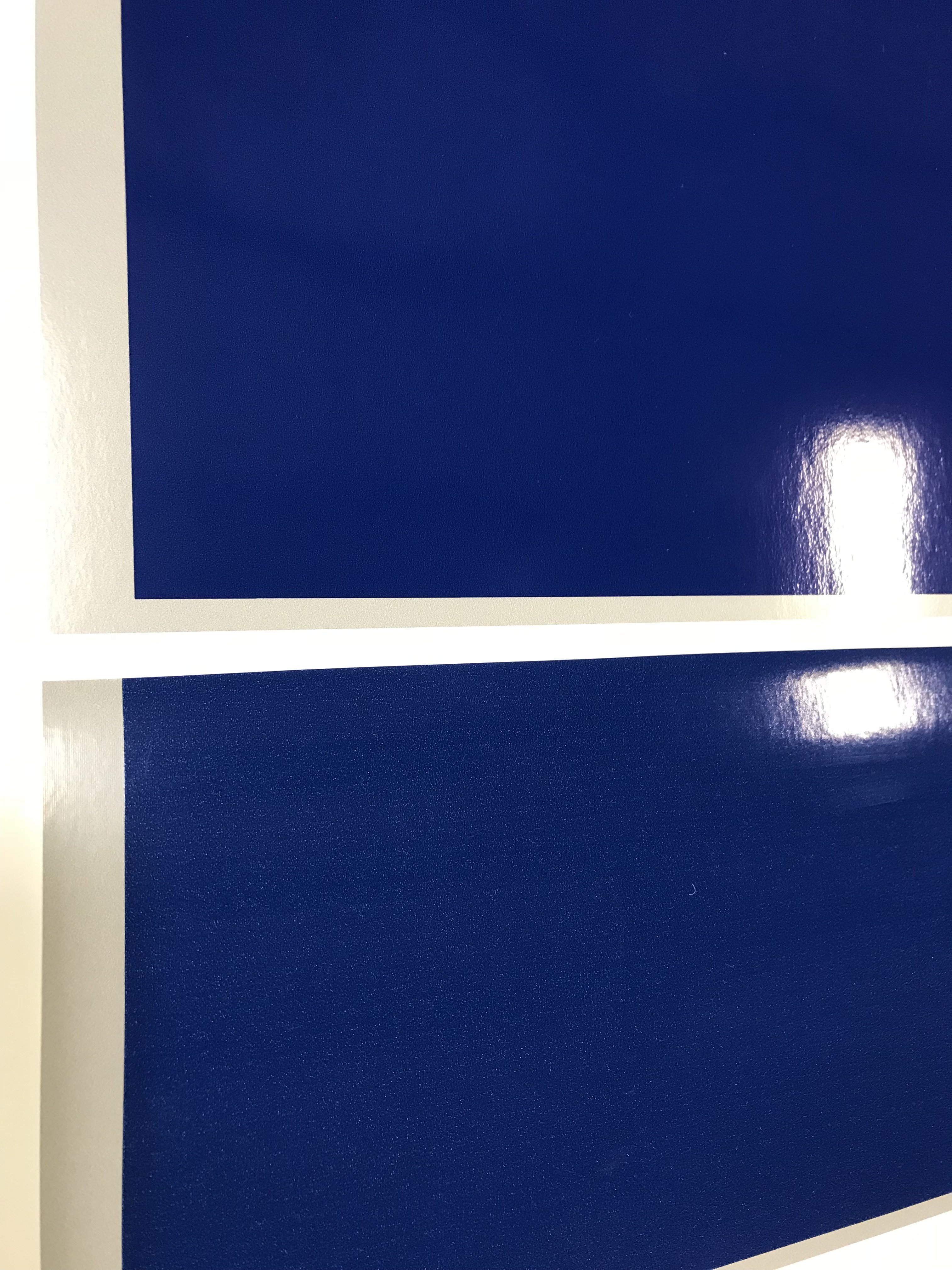

Here's how another roll of 3M prints... I had IJ39 in stock so 'gave it a try. Smooth and solid as expected. I called my supplier and they opened a claim. There's a roll of IJ180Cv3 on the way
*max zoom on my iPhone... texture in colors are pixels

Sure I hear you but as I'm not trying to "buy" it... I'm trying to get it replaced by my source... it's different

Well got the 175, printed on it with the ij180 profile I have. Very little to no banding on the standard mode. None showing on the high quality. Absolutely NO white dots showing through. Cant wait to see how it wraps, since I always thought the 180cv3 and mc was way to aggressive.

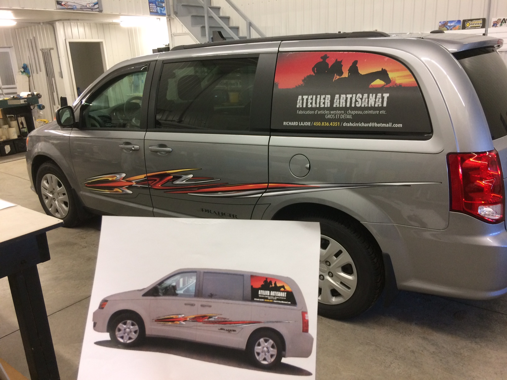

I have used many rolls of the 180 along the past years, from their original one, then the v2, v3 w/o any problem. During Holidays, I received their lastest version, marketed to be even easier to apply, so I was excited and can't wait to try it on a job. I printed a graphic kit (like 3D stripes) for a minivan owner. It outputed really bad but the customer was so amazed by the overall look that he didn't noticed the details but I wasn't happy at all (not my type to work just to collect the check... I proud in what I do). The 2nd job was for a semi (the tractor of a milk tanker... the owner has +8 units...) and he won't notice either.
2 on 2 for printing issues described above was enought for me so I called my supplier and reported the problem. I still have trust in 3M 'cause I'm a long-time user but at 1250$ the combo, I have some "expectations". I also know it has happened in every brand.
I just want a printable roll on Monday morning so I can get back on track and produce decent prints. As always.

Got a new replacement roll Yesterday. I crossed my fingers and holded my breath... I sent the same file that showed issues and... yep... again... same "/$%?& result.
Called the rep back to report it and 'been told it's in 3M's hands now (claim) but this morning, I still have a full 16ft trailer to wrap... 'Will turn to Arlon or Avery to move forward
