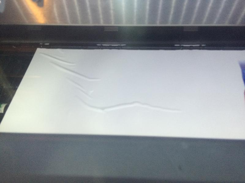

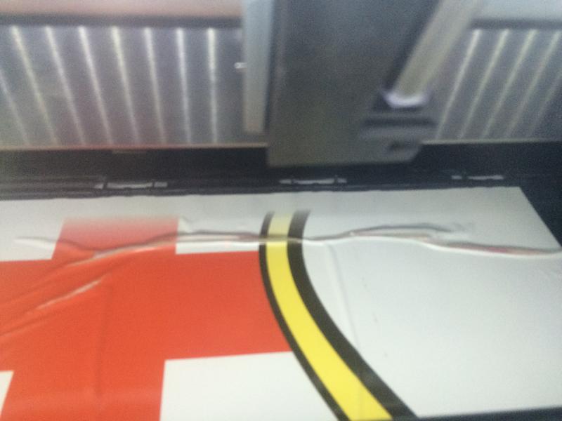

Printed a wall material (Fathead style) in my L25500 yesterday and had quite a few issues with it.
In the middle of the print I would get wrinkles at the edges of the film. It even damaged one of my printheads on Friday evening. Printhead got caught up at the wrinkle and that ripped the bottom plastic (that has wiring running through it) at the bottom of the printhead.
I know that there are issues with the heating of the film at the first 2-3 feet of the print, I usually put colored lines at the beginning to eliminate that before the real printing starts. But, I was getting these wrinkles even after 6-7 feet of printing.
I started with a regular setting of 55-110 C and 30% airflow. Later I lowered down to 50-110 C and increased the airflow to 45%.
Anyone has any idea why is this happening?
Thanks

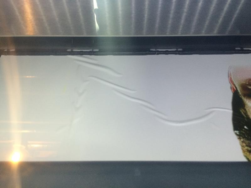

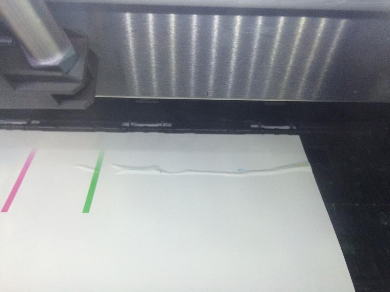

Dennis422
More pics

CES020
What's your curing temperature? 110C? If so, my guess is that's too high. On our machine 110C will blister materials. It blisters the vinyl and the backer. We have to come down to 103-104C to stop the blistering. I don't know if that's your issue or not, but you might try running it with the temperature cut back a little and see if that helps.
dypinc
How many passes?
Probably need to go to more passes less heat.
AT 20 or 24 passes if you can't get the heat low enough to cure properly and still have these wrinkles then the media is simple incompatible with your printer.
Dennis422
It is set to 10 pass.
Pre-heat is set to 50C, the cure is set to 110C. These wrinkles are showing up before it is printed, I'm guessing caused by a 50C pre-heat temps.
dypinc
More likely the curing temp. Back it down to 90C and then bring up 5C at a time to test, but you may have to go to more passes. 10 Pass is a little low for vinyl anyway.

Two things could cause this.
Heat but you lowered. So you should be good.
and
Too much tension.
Materials without paper backers, such as PVC banner vinyl tend to be more temperature-sensitive, and head strikes is often times the result of over heating these media.
In this case, the media has a paper backer, and the adhesive on the media is tunneling. Tunneling is more often related to adhesive degradation, or the film's inability to adapt to the serpentine paper path used in the HP Latex L2 and L3 machines.
Snydo
find a profile with 18-24 Pass UNI-dircectional and cut the heat waaaay back and you should be fine. The "re-positionable" stuff barely has a bond with its backer and therefore any heat stress and it releases.

Dennis422
Thanks guys. I like the profile (color) that I use now. I will try to lower down the heat and increase the passes.
