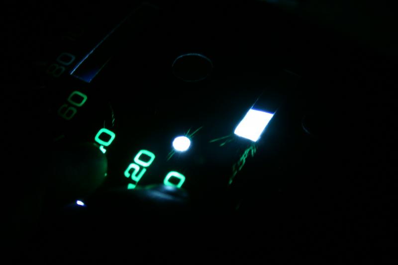

We are using the highest heat setting on the edge, all the vinyl is stored and kept in a temperature controlled front office area. The environment that they are meant to be used is inside of a car behind the clear lens in an instrument cluster. However the ones that are inside our temperature controlled front area and not exposed to anything are having the same thing happen to them.
As far as the issue, the black looks perfect at glance but as soon as you put the sample up to light you can see the tiny cracks in everything.
Here is a picture of what is happening, it looks like it is just happening where the cuts are but that is not the case. Is all all throughout the entire print area just not in the picture.

petepaz
we use the zeronine jet black foil. never had it crack after it was out in the field but sometimes had issues printing on the lex edge. it was like the foil just didn't stick to it 100%. i believe the issue was with the lex edge because other colors would do it also. never really got it resolved just had to print more nameplates to get enough for the order
