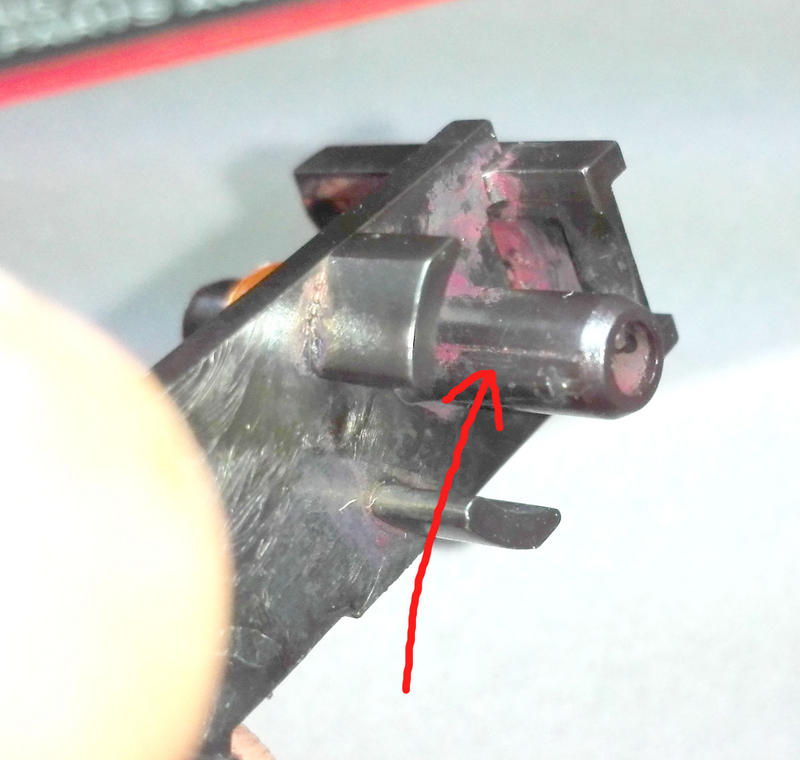

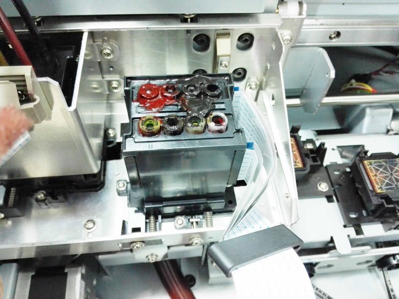

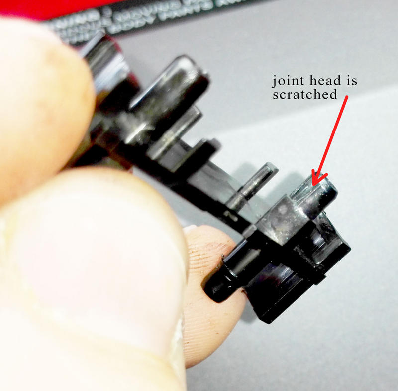

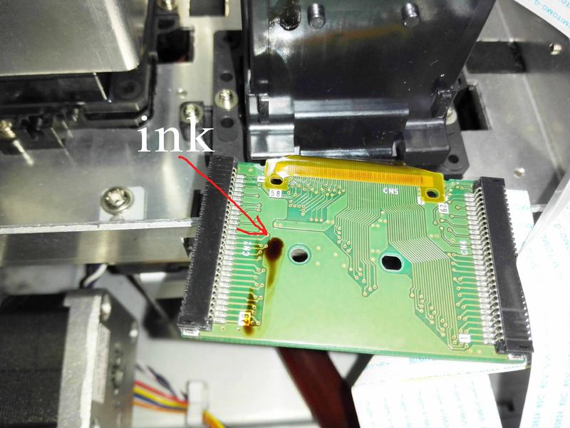

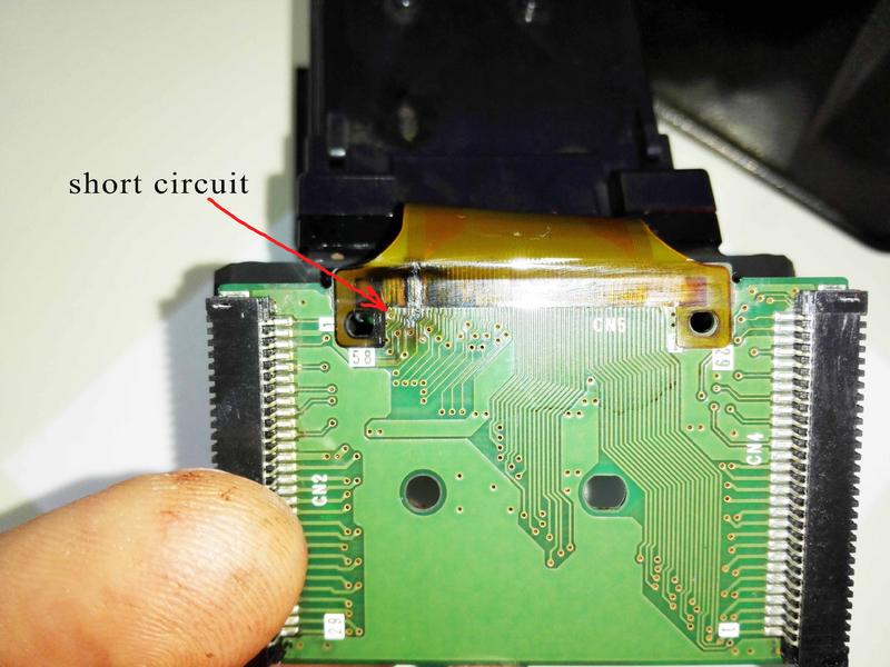

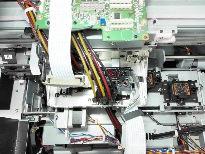

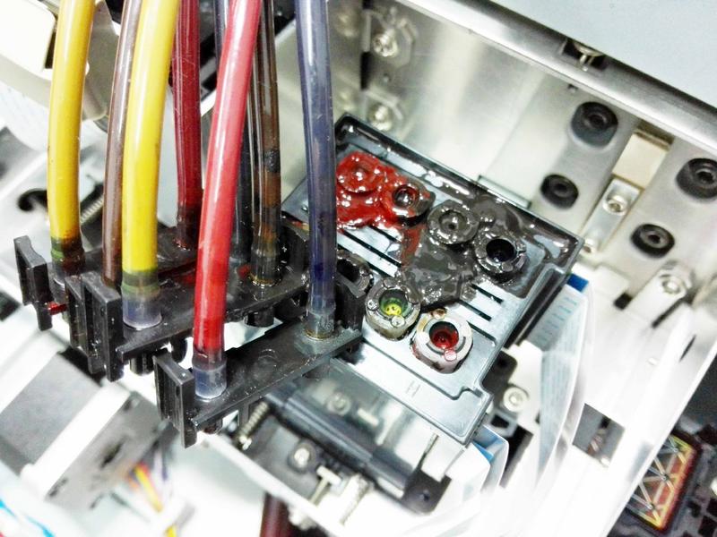

Happened to me last month, due to faulty joint-head connector,
ink flowed into the head and made short circuit.
I had to exchange the print head.
if this information will help someone I will be glad.
