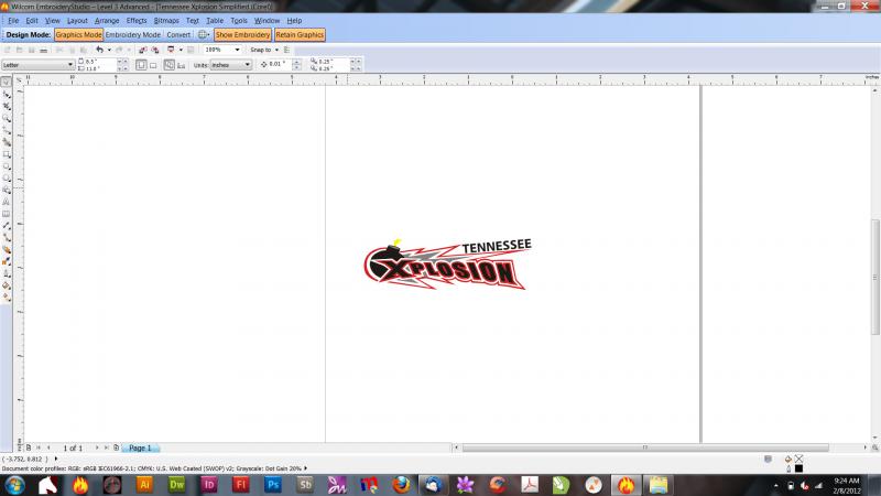

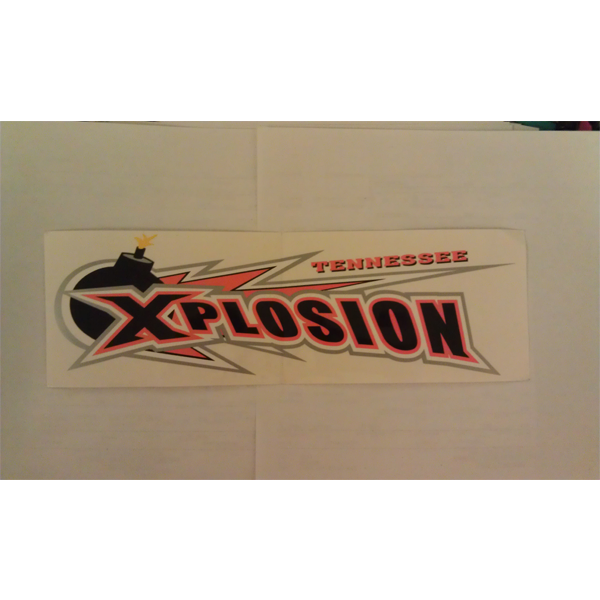

I had mentioned this I think around Thanksgiving, but I actually had a jpg come in that would work converting from embroidery to vector.
The first picture is a png version of the jpg that I original got in the email.

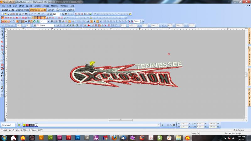

The second is the actual manual digitizing of the sticker into embroidery for shirts and hats.
The third screenshot is the vector output of the file. I had changed the "TENNESSEE" fill to black to make it easier to see.

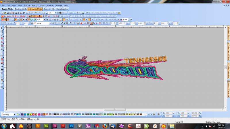

The last screen shot shows the issue of trying to get this to work with a DST file without a color stitch chart to go by.
Now the first, correctly colored, embroidery screen shot is actually of the native EMB format. Which is vector based, difference being is that it contains stitching information instead of strokes, fills etc. That information is used for the exporting phase then you get the embroidery file that is in the last screen shot.

It does have a few toolbar menus that's for sure. While the vast majority of them are related to embroidery, this software does handle multi decoration methods for apparel. Some of those tool bars deal with Rhinestones and some handle Sequins. The other method it has it's print (DTG, sublimation, transfers) and cut vinyl. It handles the print and vinyl through CoralDraw x5 which is built into it. If you look at the screen shots around the top left quadrant you'll see two buttons, Design and Embroidery. Those are "toggle" buttons for the different interfaces.

Thanks. It took about 2 hrs to manually digitize that pattern.

Very much like what the Vector Doctor does, just have to worry about some different things that apply to embroidery (underlay, compensation, stitch angles, density etc).

The biggest advantage as far as I can tell is the ability to accept more files. Even if it's just one file (CDR). I have yet to see Ai CS5 properly render on my computer a CDR file. I actually don't have to worry about what file format that a customer sends me (except the poor quality raster thumbnail) as long as I'm current.
There is also the notion that Draw is more intuitive. I don't know, I learned off of Illustrator first, so it's hard for me to judge that. You are right, the "higher up" level of embroidery software seems to either interface with Draw or have a Draw-like interface moreso then Ai.
