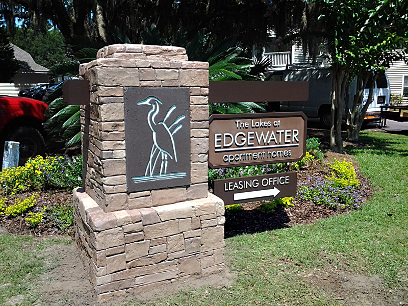

Just a small custom column with signage
SignProPlus-Chip
Steel and wire lath form, custom sculpted concrete, and painted for a faux stone finish.
Stands about 5' tall and weighs about 450-500 lbs. We built it in the shop and transported it on site for installation.
SignProPlus-Chip
Really nice... I'm guessing you cast the logo art?
Yes, it's about a 1" thick concrete casting with wire lath in the center for support. We CNC routed a reverese image, built a mold box and poured our concrete mix in. It was then bonded to the sub frame during the scratch coat
The faux finish is very convincing. :rock-n-roll:
Thanks! I had fun doing it...basically a base coat of our lightest color, and two darker browns. You just thin the paint and keep glazing the brick to achive different variations in shade. Some sponge work for "texture" then a double coat of flat clear.
