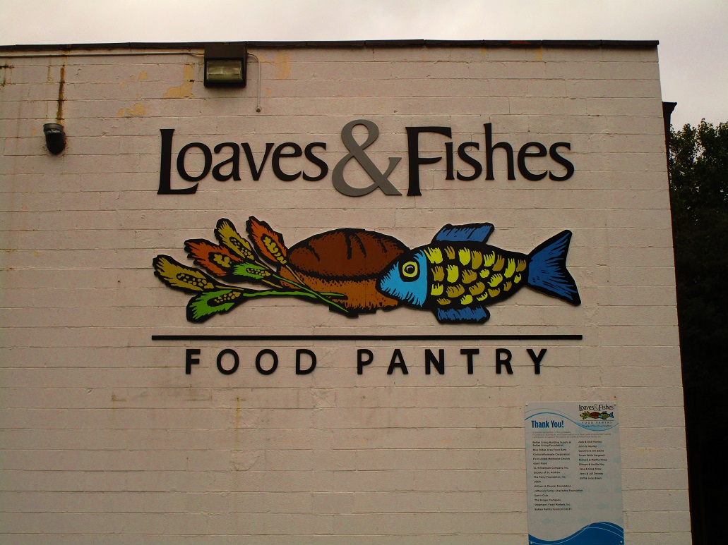

Just finished this sign today

To stay a little more on topic, wall should have either been stripped or painted. The sign itself looks good, but against that wall it seriously detracts from the finished product. I think Tim is right. It would have been pretty easy to paint the section behind the wall, donate the remainder of the paint to the pantry so they can match it for the rest of the wall, and be done with it. Wouldn't have cost you too much money and you would have gotten a warm fuzzy feeling for doing something nice.

So I think we can all agree that at least to some degree the wall should have been painted. Who's responsibility, that is up to debate. But without all of us knowing the context between the customer and sign maker I think we are speaking a little out of turn. Every job I take on I try to point the customer to the most professional, durable, elegant, proper method but inevitably they try to knock you down to something cheaper and crappier, not always but often. So after I educate them then the ball's in their court. If they so choose to half ass it then it's my duty to either turn it down or do what they've asked. Nothing more, nothing less. So when a non-profit needs a sign they are going to make choices about which corners to cut, and that's their right. Maybe they will come back and paint it themselves after they get some donations in, maybe they won't. But I'm left with a little bit of a sour taste from this post, the sign maker did excellent work on a crap wall, perhaps there were some actions that next time would help such a situation (communication, communication, communication). So I ask do we post on Signs101 to get help and educate each other? Or to belittle and harass our fellow sign makers? Maybe use a little polite tact to explain your opinion and maybe the person who made the OP will actually gain something from your opinion? Shit talk closes ears. People generally respond better when you take a kinder tone, even if you disagree with them, and maybe they'll even learn something from you. It's kind of an over arching theme these days, spout your opinion aggressively without any desire for civil discourse or actually finding the roots of the issues. I think the sign industry has a lot to gain from networking with each other instead of shitting on each other every chance we get...

If I saw this image, I would be giving it a huge thumbs up and a "good on ya"
And stated: "Excellent dimensional re-creation of an existing logo placed on a wall"
I have to retract that since the letters were not recreated correctly
My only hope is that the contractor who paints this wall, will take great care of that sign when either media blasting that wall, or using a high pressure washer and damage what I consider a nice replication. After that, they use caution when going around each replicated letter and graphic form.

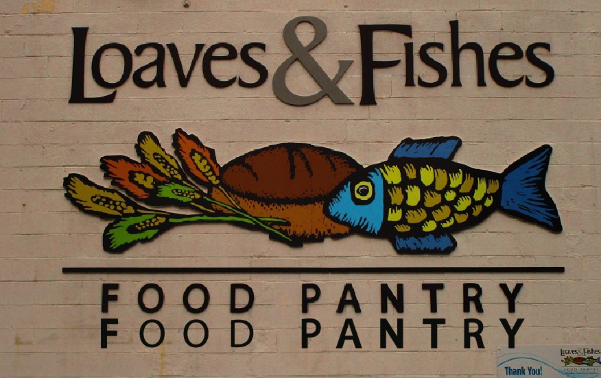

Wall painted, now I will never post another one of my job photos again.

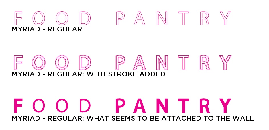

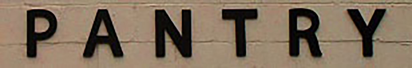

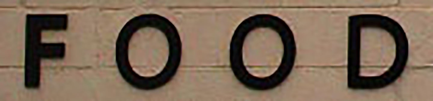

I just noticed, look at the "O,D, - especially the P, A and R" where it say "FOOD PANTRY" the router cut the outside of the letters fine, but the inside of the letter are not offset to take into account the bit width. I don't know what routing software you are using or of the letters did not compound, but you have to double check to make sure those pesky holes are rendered correctly...
ADDENDUM: It looks like it's possible the "OOD" is correct, and the outsides of "F" and "PANTRY" were rendered incorrectly because the typeface looks bolder than what's on the banner...
Either way, I would look at my cut file and see what happened.

ams, Rick is correct on this. The counters of the letters are in fact cut incorrectly. I saw it in your first photo and it can be seen in the last photo and the photo of the letters on the ground before installation. Just trying to help you out... do with it what you will.

And I would tend to agree with you except that when you zoom in...the distortion would be consistent, but here, the distortion is only there on letterforms with a hole in them. And that LOAVES AND FISHES are rendered fine.
Believe me, it's a common mistake. For a short while, I product trained people on the use of engravers and CNC machines. One of the main issues I came across was making sure the tool path offset was consistent...

Amazing how many things you notice when you stare at something long enough...I definitely didn't see that at first.
At first glance in the OP all I noticed was a nice looking sign on a chitty backround. Go figure.

It really does look a lot better with the wall touched up, but Rick is right about the centers of the letters. And as I mentioned the white-space between the Loaves & Leaves is excessive. Those two components would have nested really nice if the placement was more like the banner.

Rick's sole goal on this forum is to make me look like an idiot. The original line was 0.8" wide, That is too thin to use 1/4" thread alls and would be breakable, I increased it to 1.5" wide. All letters were thickened with an outline to fatten them up. Some strokes were thin. Having a 1/4" stud near say 1/4" from the edge of the acrylic makes it easily breakable.
Also the font is not the kind of font that is a perfect stroke. It's bolder on the left side and thinner on the right, it's more noticeable when it's thickened, so it's the font.
You throw out all these "You did it wrong, you don't know what your doing" without knowing the facts. You should have asked me "Why is it like this" instead of assuming I am an idiot.So you have no right to accuse me of anything without knowing the facts first. But will you own up to it and admit you were wrong? Hell no you won't.
The font on the banner you copied had a consistent stroke all around it. Your letters clearly were "thickened" but the centers got cut too much. Your excuses are "It's the angle of the photo" or "The stroke is thicker on one side"
Just like the excuses you made for the background. "They couldn't paint the banner cause it was screwed into the wall"... "We didn't know what was behind the banner"
You do sloppy work and get upset when other people point out the flaws and try to help you get better. Block me if you may, I'll block you and raise the average IQ of the postings I see by 70 points.

Never entered my mind to ask "Why is it like that?" Why may you ask? Because I trained many sign guys on how to do this, I know that typeface, I know the mistakes we all do. My experience tells me that something happened in the long process, and in a hurry, things happen. We all do it. I actually would like to be wrong so I can learn something... so:
I can say without a doubt that though I know the process of sign making, I do not know the intricacies of this particular sign, or the experience of the person manufacturing of the sign. And that though my experience tells me that something happened, I may have made assumptions and may possibly be incorrect in my viewpoint...
While I don't "know" all the facts, the fact that shows on the final product is that the lettering seems flawed and it's a common mistake.

It really is hard to know everything in this business, and mistakes will happen if you do it all. As simple as a CNC machine might seem be, if you don't double check before you cut, chit happens.
