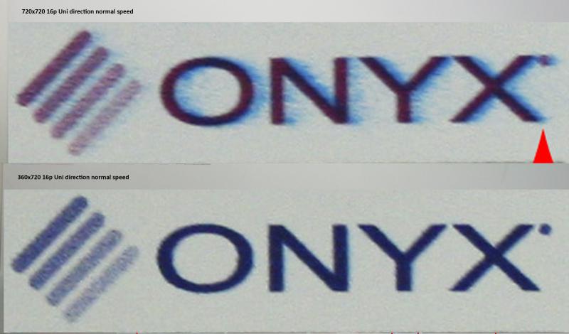

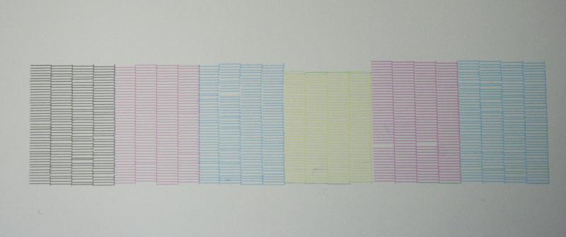

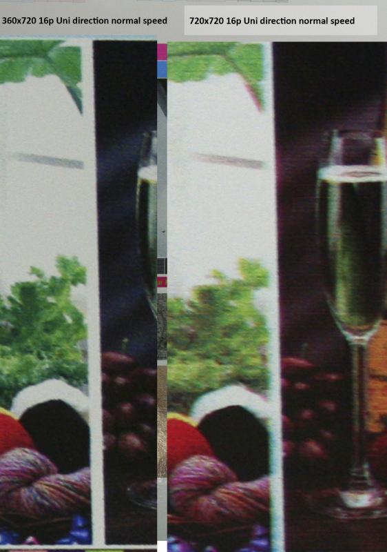

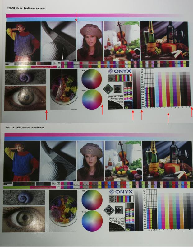

Hello, We have a Mimaki JV3 SPII.
The machine is working for 5 years perfectly the only things we have replaced are the head (one of them) and the slider board. We used to print only 720x720 8-16 passes, but by the time of usage the machine started to make “satellites” and at the moment we print on 360x720 16 passes and the quality is excellent. When we put it on 720x720 quality gets pretty bad whit huge “satellites” and color shift. The Rip is Onyx Rip Center 7.0 and ran tests with one profile on 720 that was perfect when it worked properly.
If there is someone who can help me to resolve this problem I’ll be very thankful!
