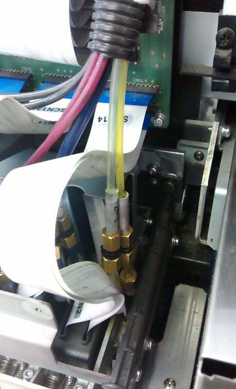

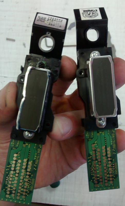

So I contacted our technician and told him the above story, and he asked me to take pictures of the heads and once I did, we noticed that the yellow (closest to the docking station) had a pretty sizable dent in it! (photo attached) His answer was to replace said head (not cheap). And that was what I did today, I managed to replace the print head with relative ease.
When all was said and done, I decided to make another test draw, and to my great disappointment, nothing had changed.. However, upon opening up the head, I noticed that one of the feeding tubes was completely clear and I was able to see through the other one, although it was still stained with ink, as opposed to the other one (photo attached), whereas all the other colors I couldn't see through at all, presumably as they were filled with ink.
So my new assumption is that the feeding tubes are clogged somewhere in the machine, out of sight and out of reach.

as u said that the moving carriage hit the docking station & thereafter you missed yellow,,, i think that the yellow pump's input tube get disconnected from the bottom side of the capping. (Capping = Where the head goes & rest, a rubber pad with a metal plate with holes inside). If so then there will be no ink suction from the head.
Plse have a close look..you can easily fix it back if it is the problme......thanks.
FelixCG
I'm not sure that that's the case, as the yellow part of the capping station is on the far side of where it knocked together.
Also, it wouldn't explain why there is no ink going into the feeding tube connected to the slider..

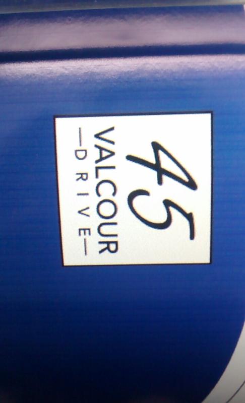

Ok, so the ink is flowing flawlessly again.. buuut.... now it's off alignment from the other colors.. of course...
It's just ever so slightly above from the rest, maybe a millimeter or two, or an eighth of an inch for you guys bellow the border. (the art was sideways in the print in the photo).
The head didn't seem to have much room to move when I was replacing it, but that might still be it?

if thats sideways, you need to do a drop position to get it aligned horizontally
Im not sure if vertical alignment is an electrical alignment, or manual, but it doesnt seem off that much vertically
MikePro
+1 your vertical alignment won't usually be off much after replacement, as the head doesn't have much room to move here.
I'll dig around for my manuals, with notes, as its been a few years since I've had to use them BUT you definitely have to start with a physical/mechanical alignment to make sure your printhead isn't installed slightly CW/CCW out of true-square.... as there is no electronic alignment for this.
for this, I just did a nozzle test print, and you'll see the vertical lines in the grid should be parallel with the other printheads. if they're not, then you'll have to loosen the two screws and tweak accordingly & repeat until its perfect.
you shouldn't have to power-down your machine to do this, I didn't.
once squared, then all the alignment procedures should be a piece of cake, abeit tedious.

Alright, update;
After going through and through the menu on the printer and our computer softwares and not being able to find anything to adjust the head alignment, I just went in and did it manually by loosening the head and readjusting it.
I did some test prints by printing a small black square, after a few tries, the yellow was getting less and less offset, until the last one I just did that looked spot on!
Doing a full test print as we speak! But It looks like I've got it working now!

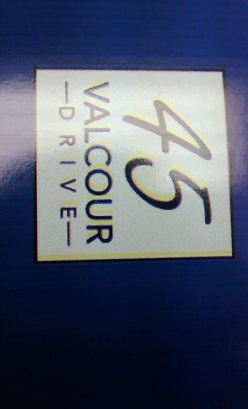

FelixCG
And we are back on track!!
Thanks everyone for your help! This website is way too good
MikePro
that banding tho'. definitely result of misalignment.
but hey, that's pretty damn close considering you only did mechanical alignments.
