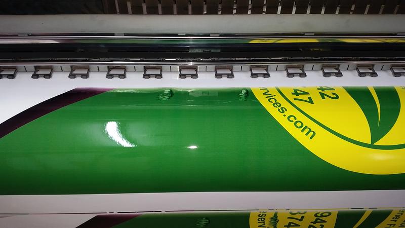

here's a photo

Did you look in to the vacuum settings? It was rare that we had head strike problems on SAV, and even then it was old monomeric (1-2 yr) vinyls that had cheap liners, ie, paper-based ones that'd absorb moisture and swell up (despite having air-con and dehumidifiers on 24-7). I would be very surprised to see this happening on a polymeric unless the vacuum is set to off or low.
Can I ask what # of passes you're using on that media? I'm used to the low-sheen appearance of latex ink now, but even so that ink looks very wet. It might be the photo. It's not smudging at all when you touch it after a good 30 seconds or so? From memory, and I do know that every machine & environment is different, if I were using 30 - 35 degrees I would only be running it at 10 or 12 pass mode. If it's on 6 or 8 pass I'd have them cranked up to 40 degrees. And all of these were for uni-direction (personal preference, long story). Which is again why I don't think it's necessarily excess heat causing the rippling, moreso vacuum. Rule of thumb too was to have the pre and print heater the same temp, with the drying heater up to 10 degrees hotter for better drying. For example, as 12 pass I would have had set up as roughly 32, 32, 40 degrees (pre, print, post), something like that.
You're really going to need to experiment with heater settings - too cold and the ink won't cure and will get wetness/spreading - too hot and you get heat banding, particularly on large areas of flat mid-tone colour. If I can work out how to attach my old test swatch I'll do that - it's got swatches and test patterns to test if the inks aren't bleeding from not enough heat, some really dark swatches to make sure that amount of coverage can cure properly, and then some larger patches of mid-range colours to test heat banding. It's tedious, but if you use that test print to hit a Goldilocks (not too hot, not too cold) on each of the swatches, then you should be pretty comfortable in printing 95% of the jobs you'll encounter. But you'll need to do it for each of your speed settings, for each of your medias.
For your higher quality, thinner medias (like some car wraps, but also some translucent SAVs), I particularly found the heat banding was a problem. The appearance would suggest that the media was rippling parallel to the length of the media and causing light & dark spots, but it's not, the media sits perfectly flat and it's just one of those weird things that large format printers do. The way to reduce it is to obviously reduce the heat, meaning you'll have to run it at a higher pass mode (eg, 12-16 pass instead of 10) so it cures enough.

PS, looking again at your photo, I'm convinced that it's not running hot enough / printing too fast for the heat settings. Theoretically if the ink was staying wet it could cause those ripples. Do you have a higher res version of the pic? I can't be sure, but it looks like you can see indications of each print head pass, ie, the stepping of each pass, and it looks like maybe 6 or 8 pass? If I'm seeing that, either your advance settings are way out, or the ink is just way way too wet. If you want to print that fast, you'll have to do some trials with temperatures closer to 40 degrees [40,40,50] (maybe 45 [45,45,50] if you're doing it bi-direction).

the head strikes are happening if ive only got about 2ft pulled through the printer, if i drag about 3ft through it seems ok and obviously if i set it on the bottom roller its fine once ive worked the media comp out, which i'm getting used to now.
