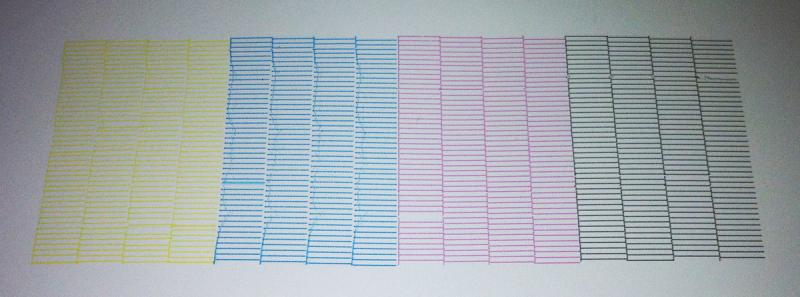

LC+LM channel was bad, tech replaced cap, pump and two dumpers that were corked, but it seams the head on that channel is corked too... won't fill up ink... we will try new printhead on monday..
4-th head was not used because of 6 color setup, that means it is brand new and full working?
here is test with lc+lm missing
http://dl.dropbox.com/u/5297373/jv3test/IMG_0060.JPG
anyone know what is wrong with vertical line on cyan test? owner told me it may be a some cleaning solution remained in the pipes... is that true?

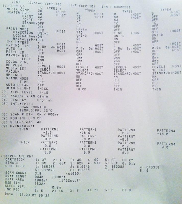

here is printed report of machine
http://dl.dropbox.com/u/5297373/jv3test/IMG_0067.JPG
I need 2xCMYK cause of double speed... and one friend told me that is complicated procedure of changing to 4 color mode and firmware downgrade and changing is needed.. is that true?
I was trying to find something about that in operation and maintenance manuals but with no luck :/

All I can say your 4th head probably needs to be replaced as well, even though it's not used while running the 6 color set-up, ink still gets into that damper and into the head.

for one the cyan is toast. you can do some data swaps to see if that bend moves to a new channel but i doubt it will. with it like that you will need avoid variable dot and you can get some decent output.

And about the cyan when you say "to do a data swaps", you mean the i need to change two cables on that printhead with another two to test it? if that doesn't help what do you think about take out that head and try cleaning with cleaning solution and syringe?
what do you think about fourth head that wasn't never used, any chance it's ok?

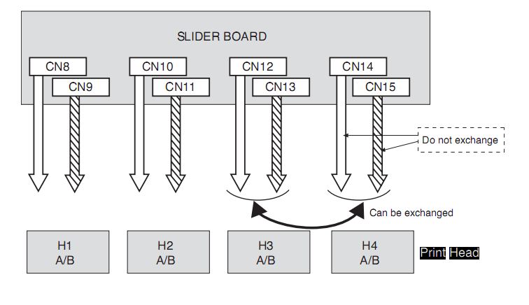

couple things. just scroll through the maintanence menu...i you see the section for inksets and it gives you a four color option then you are set. don't press it until you are ready. the machine can not reverse out of this choice!
the cyan looks like data. i have a head doing that right now. it will overspray when printing under certain conditions. if you want to see if the fourth head is good data swap to it. put a set of dampers on it from another head. do you have diagrams for data swaps? it's so simple but you'd be surprised how many people hook it up wrong.
artbot
the basic thing is to keep them in pairs top to top bottom to bottom. do not do bottom port to top port, etc. in the end it's like putting a left shoe on a right foot and vice versa.

Unfortunately the third and fourth heads need to be replaced...
We assume that the wiper is one to blame for clogging of the fourth head that never used, because he had contact with her during the work of the machine...
