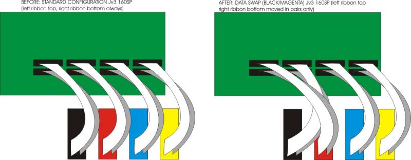

you do have an odd problem... something that should be simply mechanical is acting more like a data issue. just to rule out any data issues, i'd do a data swap right away. attache the ribbons across the slider board to see if the head will print from a different data port. this will rule out slider board or ribbon issues. i doubt it will print from a different ribbon/port, but it will eliminate a whole chapter of what ifs.
i attached a diagram of a data swap if you haven't done this before.

Thanks for the help. I tried the data swap, still didn't print. Restarted the printer, attempted a test print, fan cranked up, but nothing happened. Restarted printer again and got a "y" motor error press <ent> message.
I pressed ent and a test print began. y,m,and k printed. (cyan is unplugged from head in printer and is plugged into head outside of printer to test ribbon cable issue. Then executed regular test print. y and k are printing 100%, magenta is at about 10%. I then re-plugged ribbon cables into cyan head in machine and got error again. The other day when testing cables, I forgot to turn off the printer and got an arc. Is it possible to take the circuit board from the head not showing an error and attach it to the head in the machine?

i think i looked at that once and it seemed to me that the board would have to be hard wired into the head with tiny wires to each head. as far as the arc is concerned, it seems you eliminated the slider board. did the arc just kill the cyan head (i'd suggest ebon or special color for a new head for super cheap)? remember when you are powering down the machine to do the front/back/unplug/then push the front button four times (this may help the printer start acting propersly. it seems to be acting odd). that is the only insurance that the machine's latent static energy is gone. i personally have a cord with all but the ground broken off. so when i work on the machine, it is earth grounded but no positive/negative entering the machine.
