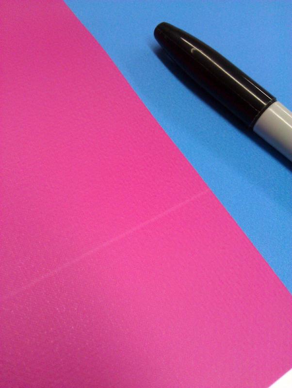

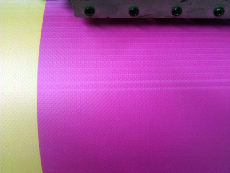

Noticed a stripe of lighter colour in a single pass on a display we printed, only in the are of the image that was red. Ran a test print, and sure enough, all colours are fine except magenta. Prints perfectly for about six or seven inches, then a light stripe. Sometimes it's just the one, sometimes it's every few inches, and sometimes it emulated ink starvation, in that it starts gradually, and either gradually goes away, or persists across the whole print once started.
