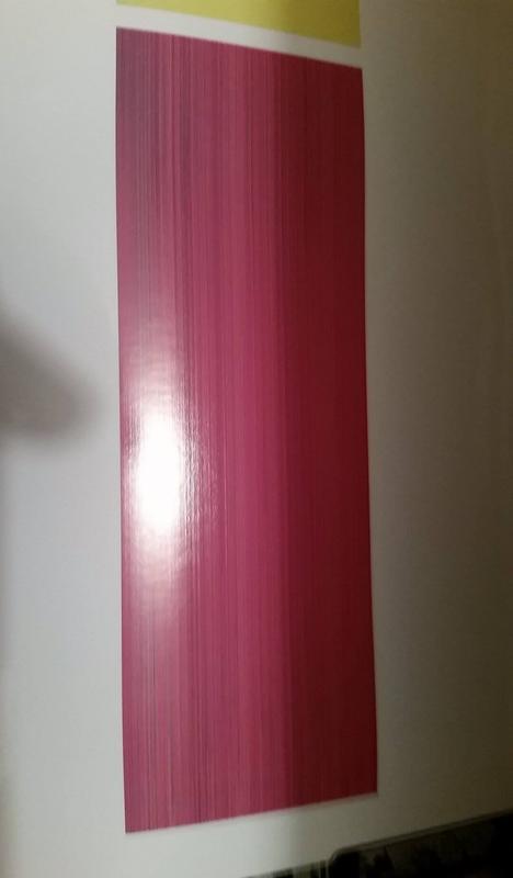

5ton
Ok finally got it to print. The magenta is coming out with blackish lines running through it though. What could this be now?

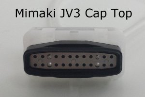

hbb2008
I know this is a few months old, but can some one post a picture of what the cap top is? Some one said they always keep extras on hand, I am just wondering what they look like and if i need to keep extras as well. I know what the capping station is, but I thought that was all one unit. in the thread it sounded like there was one for each color, Im using a JV33-160, maybe that is the difference Im not understanding.
Thanks
attachment.php
cross-contamination. ink is jumping-over from your black printhead to your magenta, somehow...
usually due to a dirty/bad wiper, dirty printheads, and/or dirty capping station.
