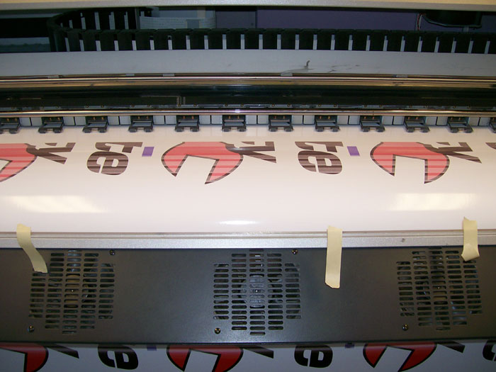

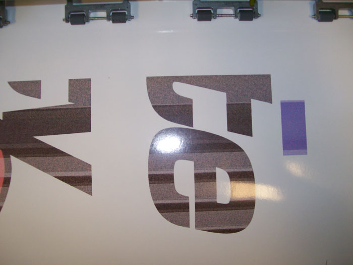

Thank you for your quick responses. I printed a few things today just fine. Then I started this job and it all the sudden started doing what I described. I have attached a few pictures to show what it is doing. It is not printing the image properly. It should be solid colors.

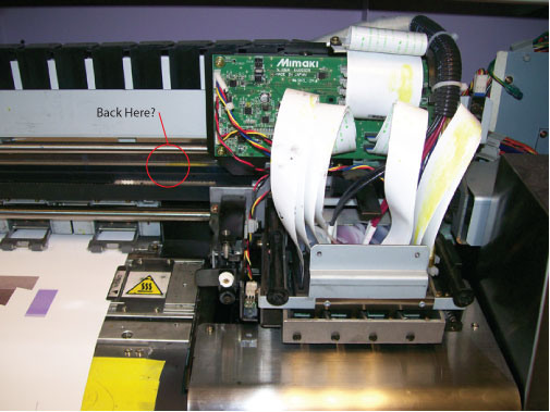

I feel a little stupid... Does the encoder strip run the length of the print area? Or is it physically attached to the carriage? I have attached a picture.

genericname
Yep, back there. Runs the length of the printer, though it's not attached to the carriage. There's actually a small sensor on the back of the carriage that cups over the strip. If you look closely, you'll see that the strip isn't actually clear, but has a multitude of tiny vertical stripes on it. Those stripes break the sensor's beam, letting the carriage know how far along on the path it is.
If you stick your head in there while it's not running (but still on), you should be able to see the red light emitted by the sensor at the back of the carriage.
