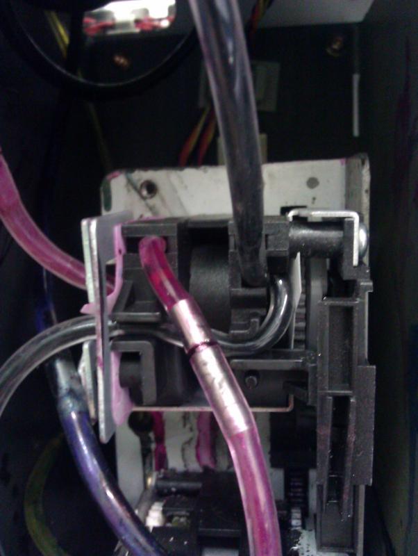

After disconnecting the lines on the pump on my JV3-160S I have got confused to as what lines go where! I understand one of the pumps is not used on this machine as it only has 3 heads.
Does anyone have a drawing or a schematic as to where the lines go to?

Does this help at all? Don't mind the mess, as I just had a line explode on me.
If the gate on the right of my photo is front facing on your machine, the rollers always go counter-clockwise when the pump is pulling ink. Lines coming from the top of the image are coming from the heads, of course, and lines going down are going to the waste tank.
