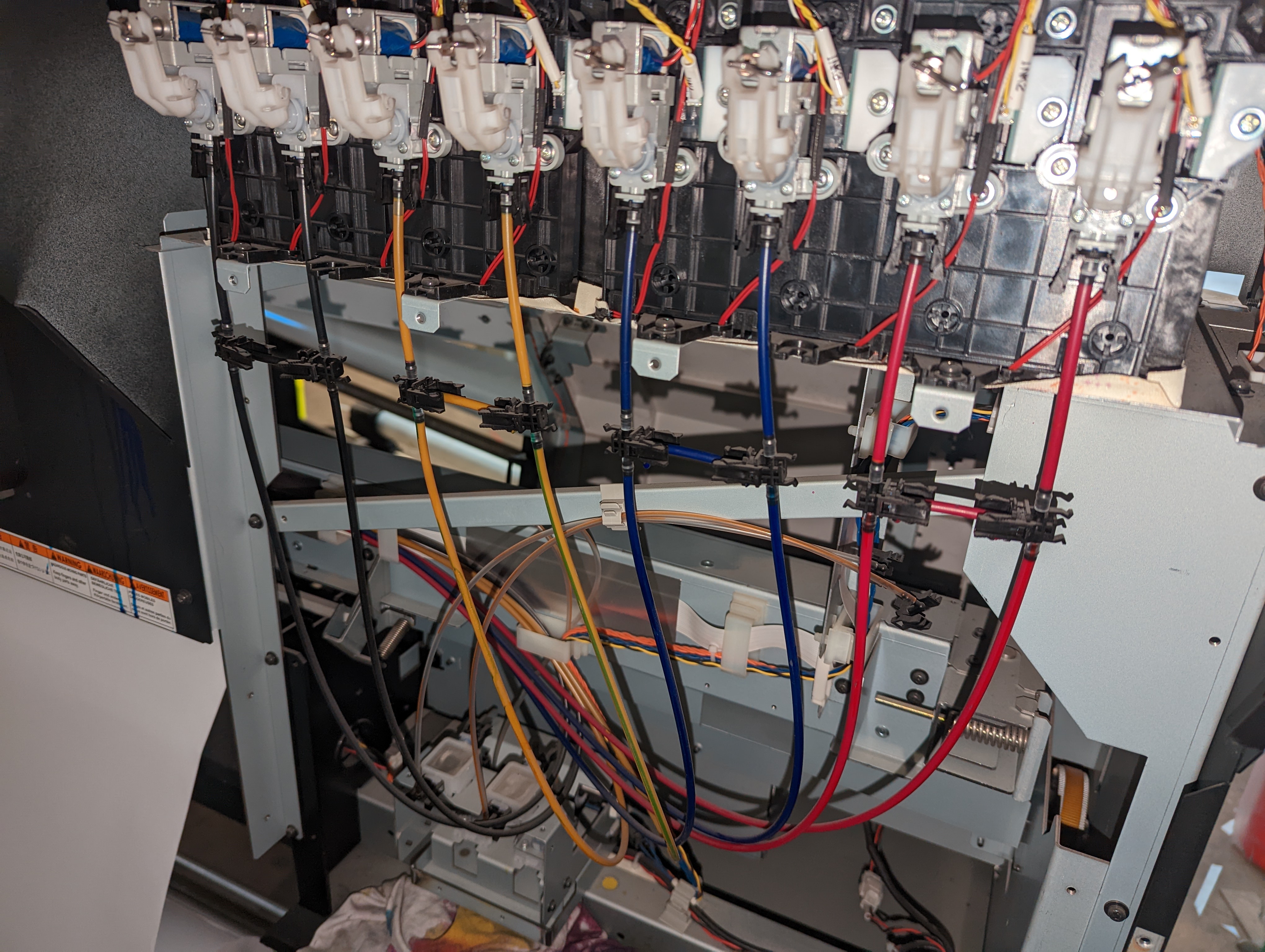

Hi all. We've just bought a JV300 to upgrade from out CJV30.
Its currently running CMYKLcLmLkOr but i'd like to convert to Dual CMYK for the speed benefit, as we wont see the benefits of the additional Inks.
1.Am i right in thinking i can just put a small section of ink line to connect the 2 cartridges (as pictured) and replace the LC LM LK and OR cartridges with cmyk ones?
2. How do i go about telling changing the ink parameters on the printer?
3. Is there anything else i need to do?
Any help is appreciated.
Thanks
Mike

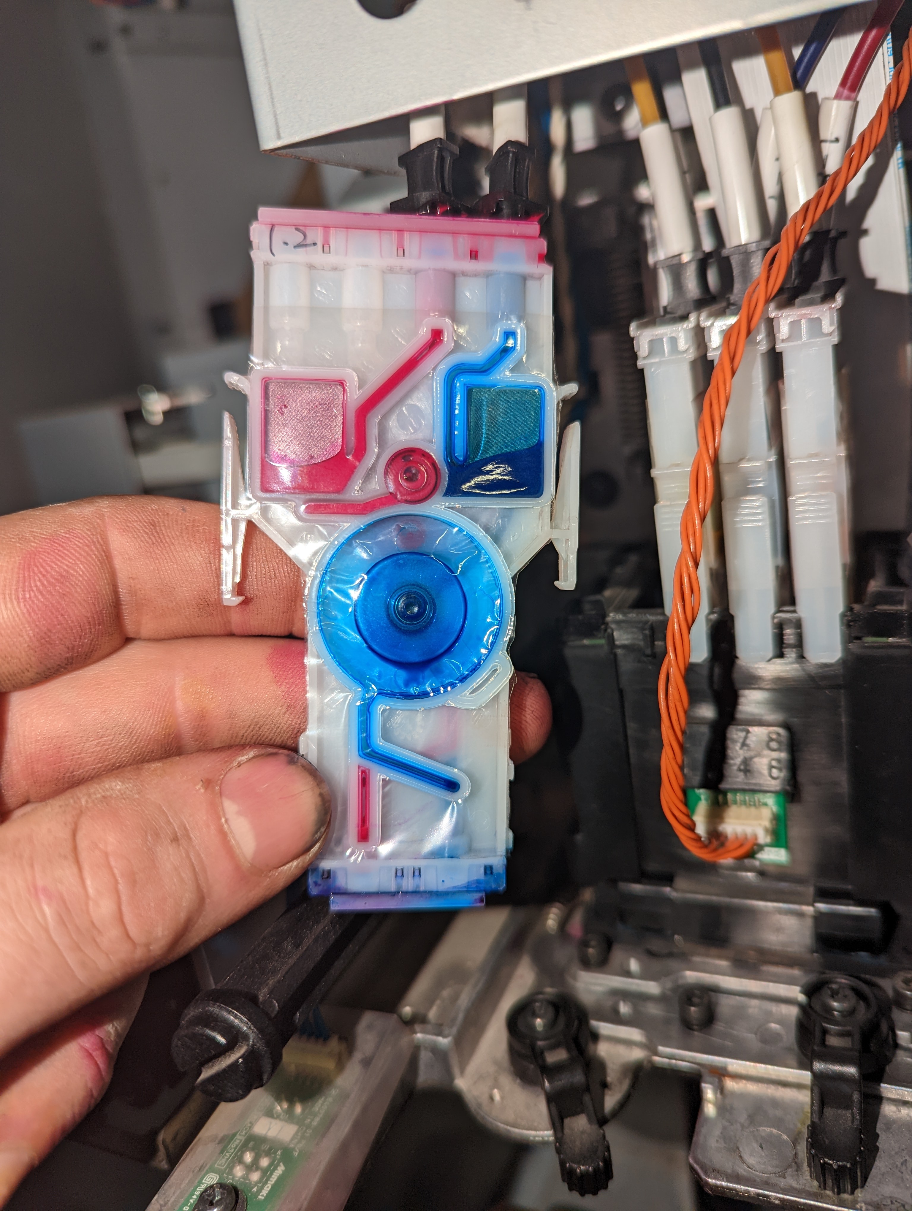

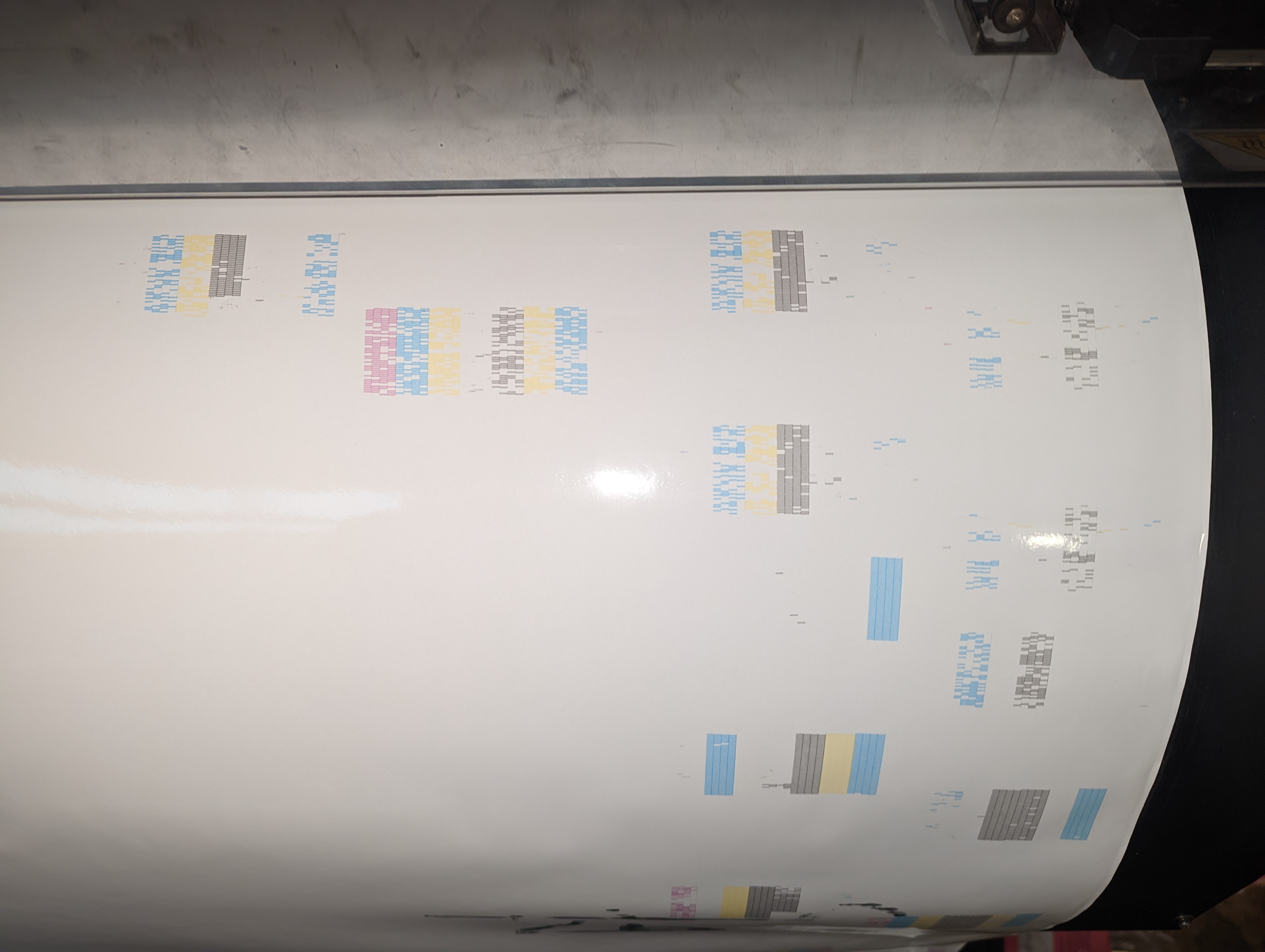

Thats great, Thank you for that. I've now flushed the system and setup the dual cmyk cartridges.
I've done 3 ink fills and 3 20 minute nozzle washes but cant seem to get a consistent ink flow. A hard clean brings some of the ink back but it drops out again. Whatever i do the dampers seem to be near enough empty.
Im guessing its air in the lines, but im not sure how to purge the air. Is there something i've missed?
Thanks
Mike
