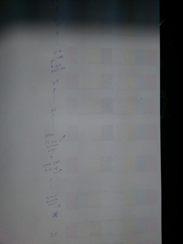

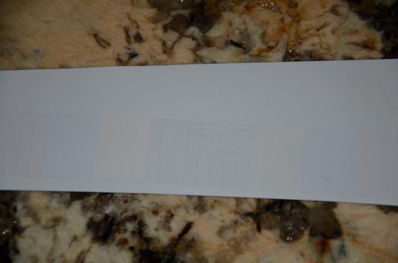

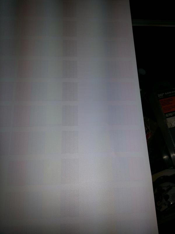

The printer had not been in use for quite a while. It's running Triangle JVV inks on the Easy Fill bulk ink system (SS21 compat inks). I am just trying to bring it back to life...
I've tried the following processes:
- Numerous nozzle washes ranging from 1 min - 24 hours (turning off the machine while head is parked on cap)
- Head swabbing (always one direction using proper cleaning solution soaked swab)
- I've performed several ink fill-ups
- I've pulled ink through the dampers and head by way of the waste lines (opening valves through menu)
- Today I swapped ink lines to the manifold to troubleshoot head vs. ink problem (the head channel comes back to life!)
Parts I've replaced:
- Dampers (but the buttons aren't "depressed")
- Filters on the triangle bulk ink system (skywalker 45mm type)
- Wiper
- Capping station
- I've confirmed pump works (drain hoses weren't in the waste jug and made a big mess)

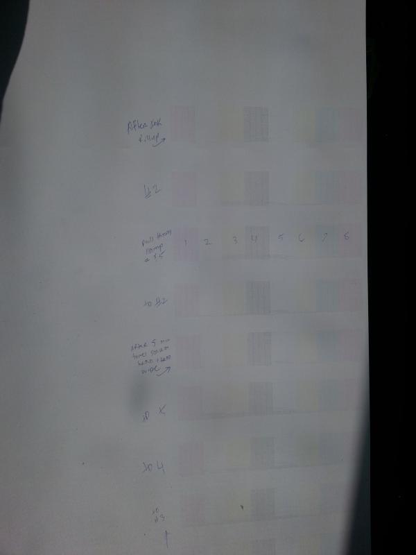

Anyway... here's the photos:
The first 3 below were trying various nozzle washes & ink fill up's....

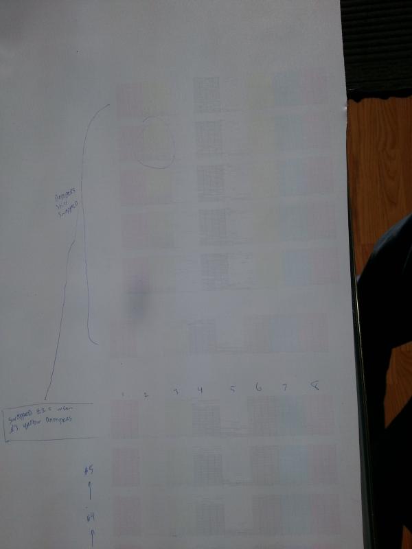

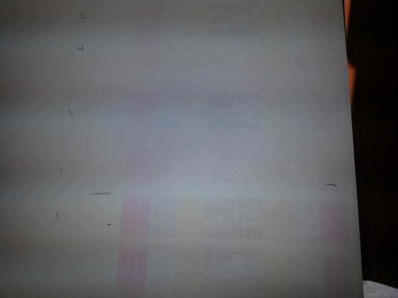

Then in these next 2, I thought to swap damper #2 (Cyan) with damper #3 (Yellow) just to verify if the reason the ink wasn't coming through the head on channel #2 was due to a head problem or an ink problem....
I'm no pro, but it looks like after the swap it wants to start printing on that channel, indicating some sort of ink/line problem going on here?....
Through the various test draws, it seems that all channels from the head WOULD work if they could get ink to them, no?
I've tried so many things now I'm not sure what do do next. Feels close to a solution though :)

I'm thinking dampers. Swap the cyan dampers and see if that channel drops out again. Did you use OEM dampers or the cheap $5 ones from china? Take a pic of your head with the cover removed so we can see how much ink is in each damper. Move the head over to the service area and tape all the valves open on the back of the machine and hold a damper open, and see if any ink flows through the head in that channel. If nothing flows, and you try another damper in that spot and still nothing flows, its time to get some tubing and a syringe and delicately push some cleaning solution through the head. You'll eventually see it start spraying through the nozzles if you're lucky.
I switched to 20/20 inks and they clogged my yellow channels. It took a LOT of work and it got 100% of one channel and about 80% of the other to fire again in yellow. I'm letting it run till it just cant go any more.
Get a LOT of paper towels handy, rubber gloves and clothes you don't like, its gonna get messy.
Good luck!
petesign
Also make sure your head is level - when you loosen the screw to raise/lower the head it can get off level, and not form a good seal on the capping station.
Capping station would be next guess, followed by head.
**Wait, i re-read your post, How long had the printer been sitting up? Was it prepared to sit, or did someone just turn it off one day and walk away?
Could be anything if it just sat with ink in the lines and head for a long time. Dry ink in the lines causing lack of flow, caked ink in the head, etc...

Sitting about 4-6 weeks with power on. But notice the various test draws. If I move the damper around, the head will actually print a nearly complete test draw on the otherwise dead channels. To me this would also eliminate the possibility of the manifold having an issue. In general the print head itself seems to have been pretty forgiving. It seems the issue is somewhere between the ink tank and the damper on the dead lines?

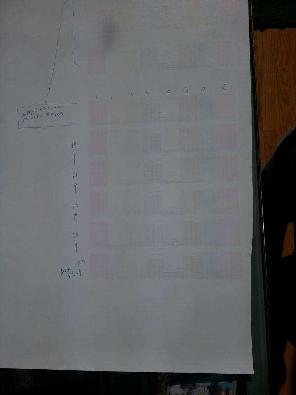

end of day update...
So here's what it's looking like now...
I used the method artbot mentioned awhile ago in this thread (http://www.signs101.com/forums/show...i-JV33-head-starving-problem-with-bulk-system) --- basically I did this...
- put some cleaning fluid in a syringe
- pulled the damper off of the bad channel
- unhooked the damper from the ink line
- opened the ink valves via menu (important)
- gently pushed a little fluid (perhaps 5ml) into the ink line
- put the damper back on the manifold
- clamp off one of the waste lines on the pump
- pull a few ml through the other waste line (to pull a bit of that cleaning solution in the bad channel through head)
- use menu to close the valves again
- 1 pump tube clean and 1 one minute nozzle clean to clean things up
- do a bunch of test draws
I had that missing black channel printing 100% very faintly (cleaning solution still passing through?) , so I opened valves again and pulled some more ink (cleaning solution back through directly from the damper bottom. That's basically where I ended today. It's sitting on an overnight nozzle clean soak right now.
Still.... not bad for what I figured was going to be a goner DX5 print head :)
I still don't understand how to clear air in the lines to the point of (a vacuum?) getting those dampers buttons to "suck" in, rather than being relaxed. It's probably something that could be accomplished by doing something bad like pull ink from the drain hose while the valves are closed. But this seems like it would damage the head?

Sorry.. pictures taken with camera phone. Terrible quality. I'll update them with a better photo with a real camera later.
Atari
better photos...
I went back to the shop and did some solid color prints of yellow and black using "check pattern" or maybe it was "all pattern" from the #TEST menu. I was attempting to clear any residual cleaning solution from those lines. Anyway, here's a better photo of my last test draw.....
Not too bad! I think I can get the rest of that black back tomorrow.
I'm really surprised it's all come back so well here. It's been sitting for over a month without use (with JVV inks). Lucky :notworthy:
