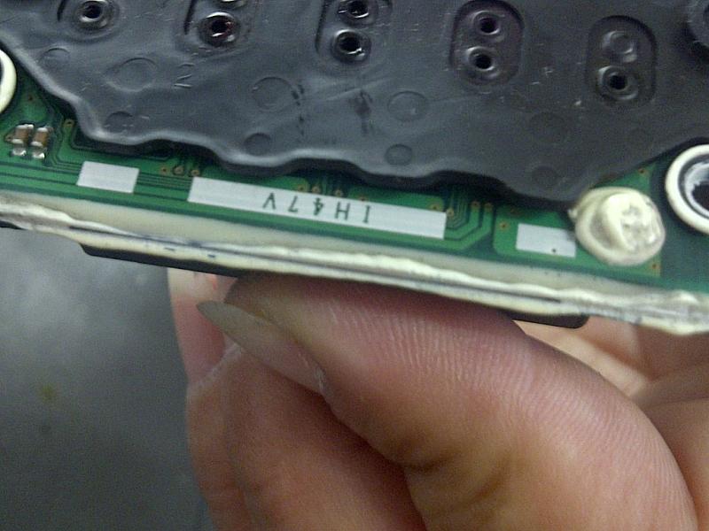

Just came across this thread again. Here is the update.
After several talks with technicians who actually worked on JV5s and few dealers:
Compatible DX5 print head will not work on JV5 but ok on JV33/valuejet (valuejet need different manifold)
Original JV33 print head will work on both JV33 and JV5 (JV5 users remove old memory card from old one to use)
Original JV5 print head will work for both JV33 and JV5 without problem.
All our JV33 print head are IH47V print heads. If your print head does not have this IH47V, most likely will not work on JV5s. See picture. Yes this is the actual print head that myself is holding on.
