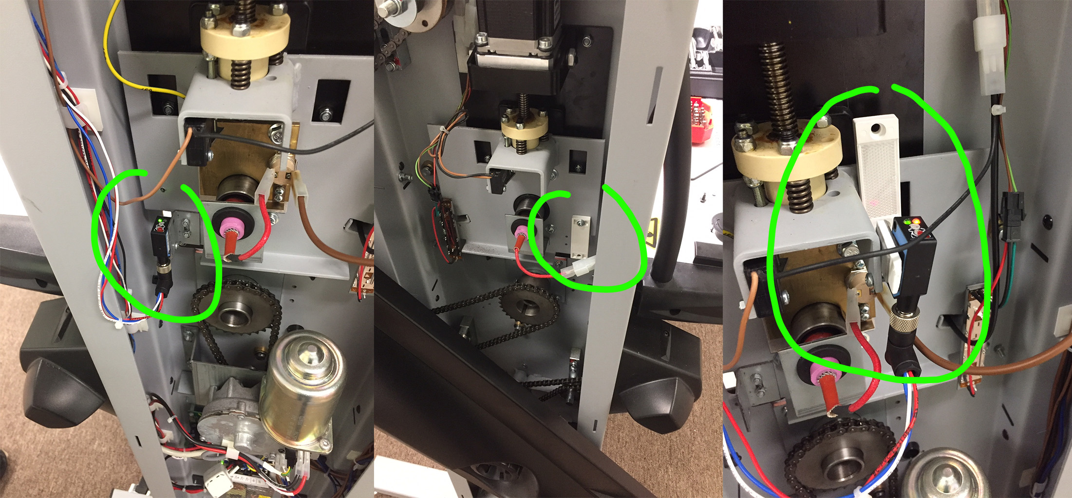

Has anybody bypassed the laser sensor on the kala? I thouth I read about it on here but can't find it now. Something about tying the laser wires together?
Have gotten used to the sensors. But today it tripped and won't reset. So I'd like to try and just bypass it for good.
But if anybody has a quick solution to why it won't reset, I'm all ears on that too.

Not personally, but I know someone who has... here is a picture he sent. Not sure if this helps or not.

Are you sure it's the laser? There is a switch for the table as well, and one on the back
Ha! Thanks, I feel dumber now. Was the big red emergency stop button on the back. In my defense, I'm the owner and don't get involved in production much anymore.. When my guys told me laminator stopped working sensor won't reset... should of checked the kill switch.

Does the Kala come with a wiring diagram? Our seal did... If it does, find which two pins on the board are for the lasers and jump them. Much simpler than connecting two wires together... Not sure if the Kala has two pins that'll work, but it looks like a similar setup.

that being said, you either bypass the laser, or the sensor that reads it.
can't this be done with a small piece of gorila tape? (electrical tape falls off)
