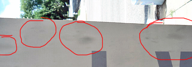

Freese
Does it affect the print area? I usually spot things like this in material I have ordered but maybe I am not looking close enough.
Do you have any pictures? I would love to see exactly what you are talking about.

Bannerday
Here's what I mean. Put the banner by a window & this is what you get.
