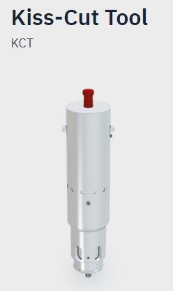

Take a picture of the setup, how does the tool look like!

Our KCT was springloaded, so the whole head moved up/down and the knife was static in the KCT.
