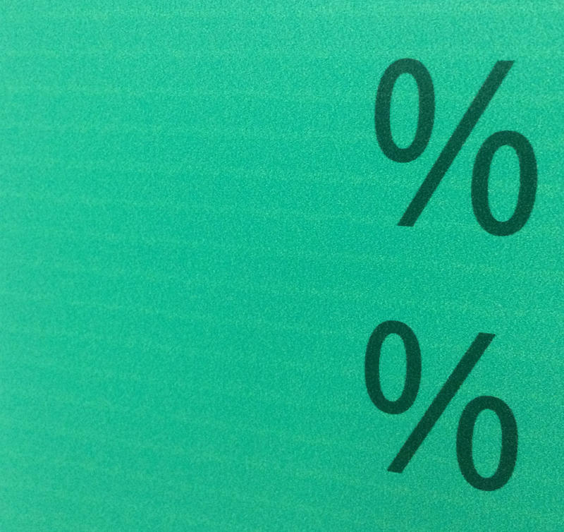

On my HP25500 the cyan/light-cyan print-heads are dying pretty fast. After printing 150 - 250 ml ink, the machine says that they had to change.
Ignoring this message (or replacing the head by the same used one), the printer is plotting well - but after some m2, there a light stripes to see (see attached picture).
If I clean the C/LC-Printheads, the stripes disappearing for a while.
Who knows, what to do to fix this annoying and expensive bug?
Thanks for any tips and hints!

Any chance your maint cartridge blotter cloth is used up without throwing a code? Also, when we have had this issue, replacing both the cartridge and head has solved the issue. Do the cart first, then some cleanings and try again, you may get away with not changing the head.

Thank you for the answer, changing the cleaning-kit was a good approach - i did it and did some cleanings - but it didnt help much. :omg:
Will do some more cleanings, maybe it will help soon.

how many passes you are using? sometimes with 6 passes that happens to me with banner material but with 8 or 10 not.. ?

Im using 10-pass, in the next days I will get some new printheads and then i will try it with other passes. we have now some holidays in austria and the supply with spareparts is very poor. :-(

Another thing to look for with mysterious banding - we had a couple of big head strikes and banding afterwards.
We tried everything and eventually shone a light under the heads.
There was a small shred of paper wrapped around something there, dragging slightly across the print causing the problem.
