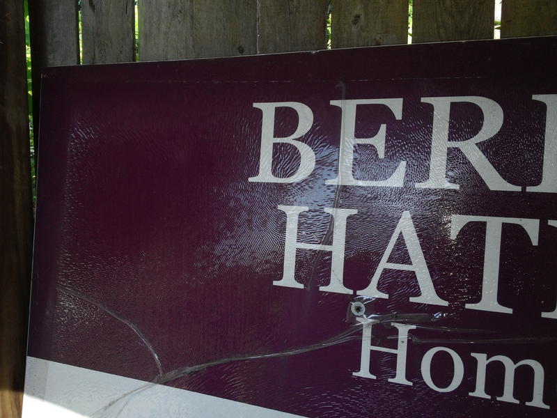

Is this what you're looking for?

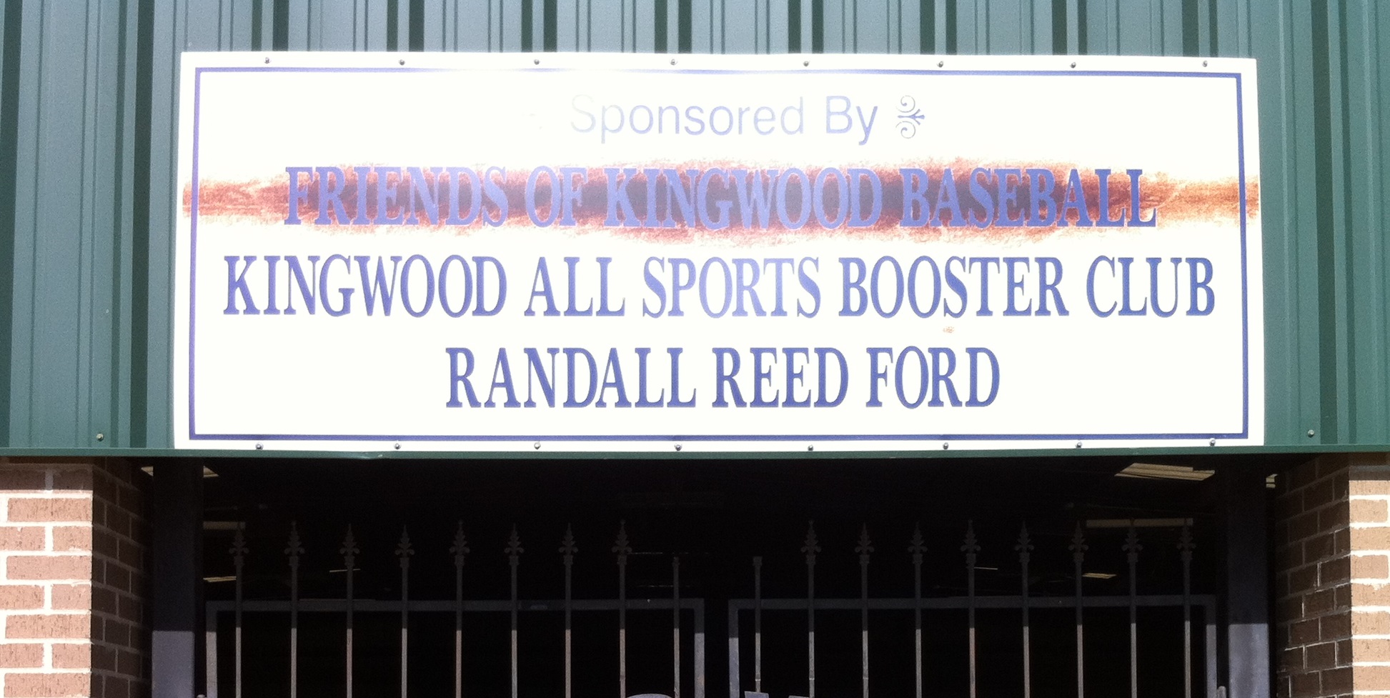

We did't make this so can't say what laminate was used. Its about 5 years ago. I never could figure it out.

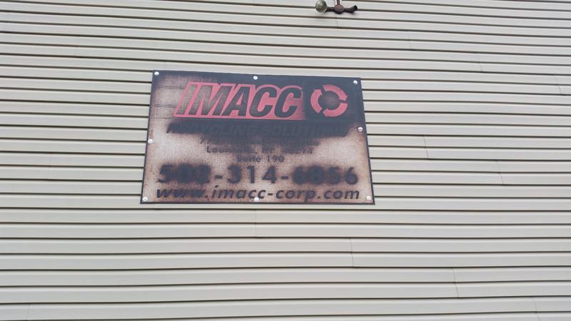

Here is an example saw the other day this gives you an idea of what the sign is supposed to be.
Needless to say I got an exasperated eye roll when I made a U turn to take pictures of the signs

Whew! Looks like several of those signs are in desperate need of replacement!
