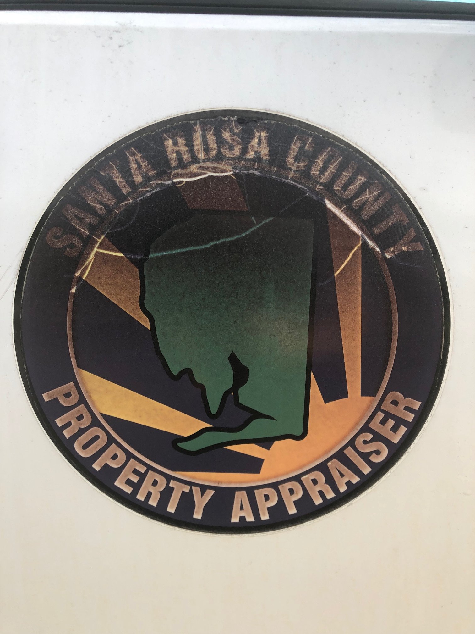

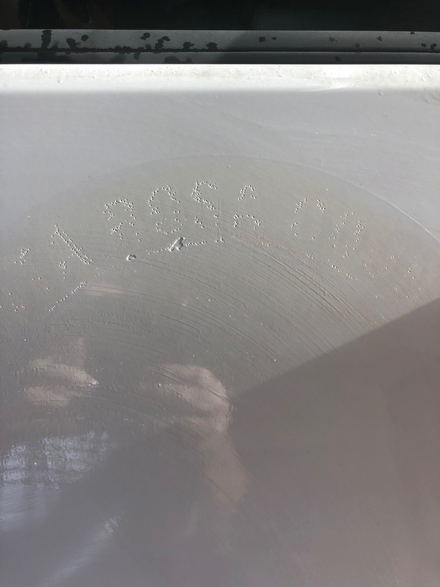

Im new here and know this has been discussed before but ive about had it with sheet lamination. Over the last 10 yrs ive tried several films and calendared overlaminates. Currently we are printing on General Formulations 222 and laminating with 290 G or Briteline. Im am giving customers an expected outdoor life of between 3 and 5 yrs and almost all look good at the 4 yr mark. After the 4 yr mark most start to look like they've been in a firefight. A slow fading would be fine but instead they become an ugly blight on the community! I have also noticed that darker colors that get hotter will age and become burnt looking sooner than lighter colors. Im attaching one 6yr old 4'x8' and a door decal that is almost 5. Note the top of the door decal is worse than the bottom. Im assuming the "roll" of the metal exposes the top half to more sun? Also note the condition of the paint under the decal. The letters have actually pitted the factory paint!
So what do I do? any suggestions or "heres what we did" would be appreciated.

I'm surprised that is happening with a cast laminate. What kind of printer do you use? How long do you wait between printing and laminating?
You do realize you are laminating over a 3 year outdoor life junk vinyl that is 6 mil ?? Laminate is not gonna protect something inferior underneath it.... and even at that..... 290 is only up to 4 years itself. This one or however many you have going bad, is on you and not knowing your products/medias.

I missed the vinyl that was being used, and although I agree that OP isn't using the correct material, I disagree that its junk. I love 222, its got many great applications. But extended outdoor use is not one of them. Also, the main reason we use it is because its so easy to install unlaminated due to its thickness. why in the world would you laminate it?

Expected exterior exposure of GF 222 is up to 3 years, in the deep south you may as well halve that. There are cheaper options that would have outperformed 222, 222 is a great product for many applications but not exterior signs. Also, you may want to try using matte or satin finish laminates, from what I've witnessed in a more northern climate it holds up better long term as far as UV burn and overall less cracking/peeling of the underlying vinyl.

Vinyl products will burn just like you experience wether cast or calendared. My recommendation would be to move to a nonPVC product like 3M 8048 or the new Orafol Laminates.
