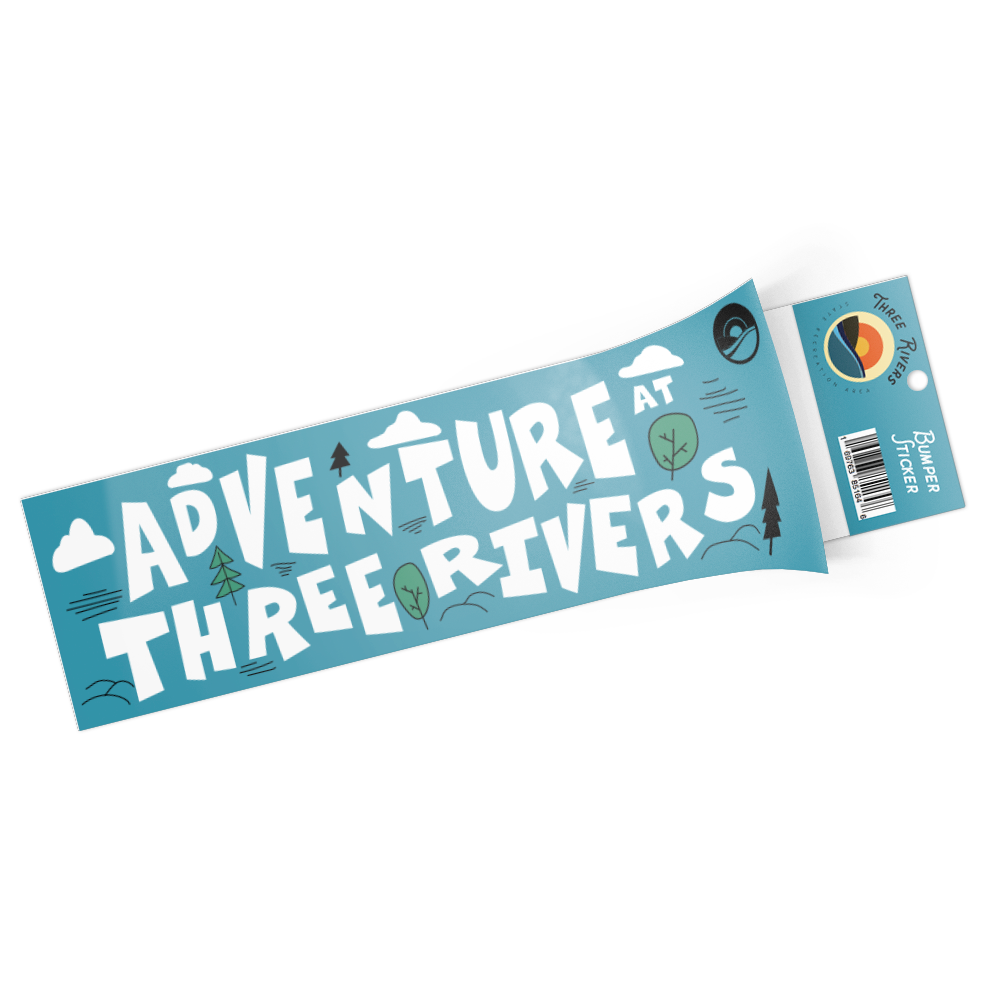

I would contact Stouse. They do all kinds of labels, and I just checked and they have a face-cut bumper sticker. Maybe they could do some kind of weird double-cut or half backslit kinda thing for you.
This is an interesting one - good luck!
