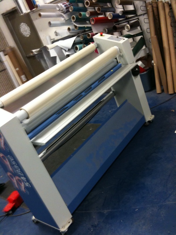

I think I found the source of my frustration....
Here is a photo of the 54 Base we have and a 62 Base. The 62 base has a roller directly attached to the table.... what roller is that and where do i get it?

I'm not even sure if this mysterious roller is available for the 54/base. I've tried sooooo many different methods at feeding these prints its made me sick. Unrolled and loosely double folded out on the table, on the rear take up roller, etc etc etc... The laminator I learned on had a feed roller under the the table and I'm so used to that. I thought I was doing something horribly wrong to begin with on this Seal that was purchased before my time here. I've had a hard time believing anyone would have such a hard time laminating.
cptcorn
adad
Just got off the phone with Seal. It's part of the Roll to Roll option for the 62 base. There is not a kit for the 54 base. The tech I spoke to said you might be able to cut the tube down, and mount the brackets, but wasn't sure.

I doubt if you could cut it. You wouldn't be able to do that to mine.
As odd as it sounds that you are sans roller, perhaps you really don't need one. It's a decent brand and did come without it.
Is the vinyl really tight going over that edge or jumping?

If I roll a 10' print out onto the table, it will begin to track off to the left after about 6'-7' .
If I run it from the rear take up roll, over the table, it buckles. It's been awhile since I've tried that.
If i run it from the rear take up roll, under the table directly into the nip rollers it runs straight as an arrow but buckles eventually after about 10'-12'.
I will say this laminator is awesome. Even without that option it laminates soooo nicely. That is, unless your print is over 8'-10' long it seems. Owner here should have went with the 62 base at the least. What's the point of buying a 60" printer?
