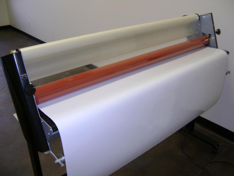

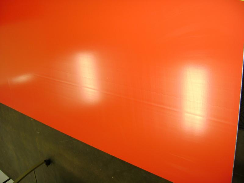

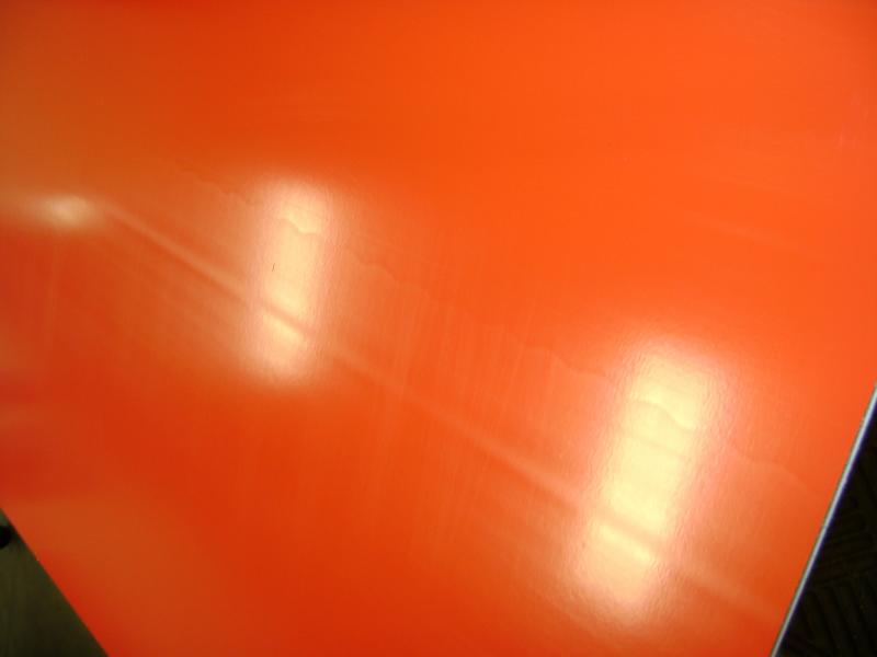

Here's some pictures as requested.

A few years ago when I used A Daige to laminate...that happened. Here's what I found out it was...and the fix.
The pressure on the sides twist the soft grey foam roller on the bottom a little while leaving the middle of it the same.
A) you can buy a new bottom roller & replace.
B) you can take it off and try and untwist it...takes forever...and will happen again.
C) you can buy a quality laminator and never have that kind of worry every again.
You can still use the Daige...for mounting vinyl to substrate...mine works great for that.
