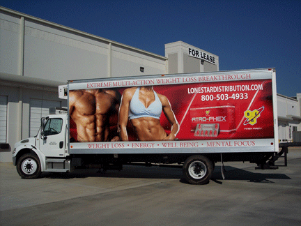

wrapman jamz
I have reduced 48' x 240" files to 8.8mb in Photoshop that print clear and vibrant.
Blazing speeds on the rip at this size. Saves time on rasterization.
How about a 9' x 24' box truck side that's 20.2mb? It can be done!
See the pic
