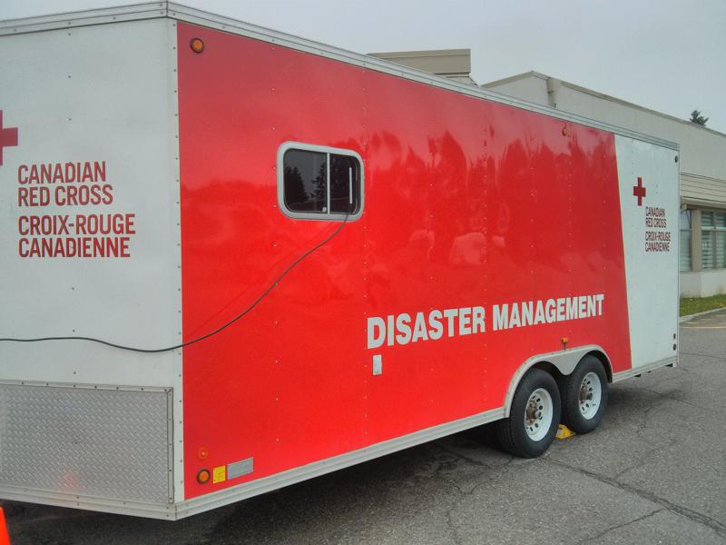

Looks like you got your answer already Mark. But I did this trailer a few years back with 751. (The Red)
It turned out well, but next time I would use a wrap cast as well.
