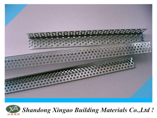

I may be waaaaay off but... have you thought about using stand-offs?
I have backlit acrylic displays in my showroom with stand-offs & bought some
perforated aluminum corner guards, to box it in and hide the wires, but still allow halo lighting & they turned out great.
