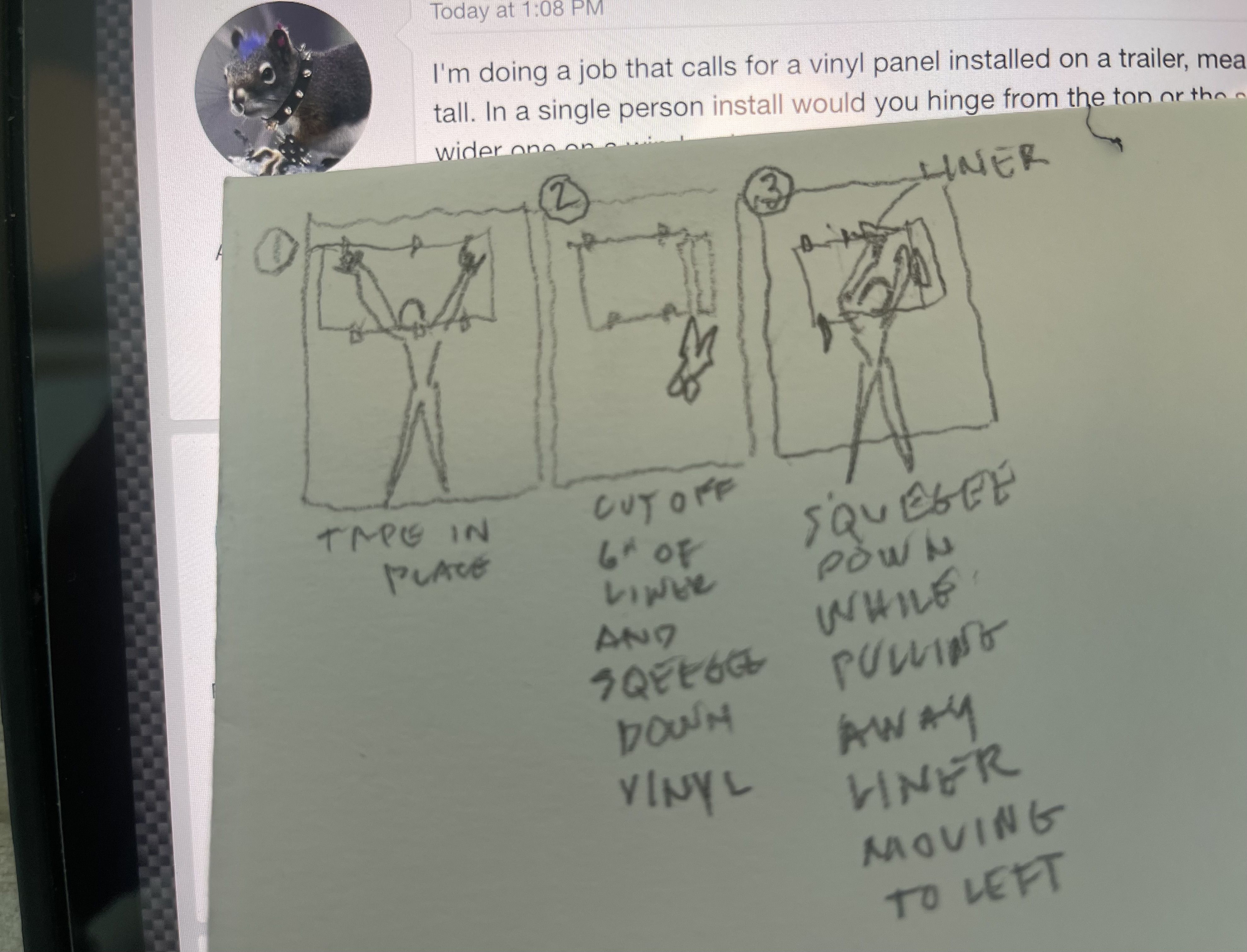

I'm printing oversize and will trim after installation. I believe the actual surface area is 70" wide x 47" tall.

I like to install large pieces of vinyl by myself by cutting a 3 to 5 inch of liner on the horizoval side and placing piece where it needs to go and adhering that section down. Then let top droop down and proceed to squeegee down and then do bottom section while pulling liner away as I squeegee down vinyl. like to cut off that strip more towards the top as it is easier as notareal stated about gravity being your helper. Gnubler, unless you have short arms, 4x6 should not be a problem. You seem to have Munchausen towards work where there is a problem when one does not exist.

I'd do it that way if it were vertical. The piece is 6 feet wide and I'd find that very difficult to pull down the liner and lay down smooth without stretching or wrinkles.
I think Gino's center hinge sounds like the way to go.

I find that center hinge on a long piece like that, now that I realize it is 6 foot wide, is that pulling back a large piece it has a tendency to bend or wrinkle.
But tell us your experience and how it came out and tell us if you would have done anything differently.

That sketch is pretty much my plan. I never thought to tape down to opposing end like Burton mentioned, and in the past struggled with trying to hold it rolled up. Too hard for one person.

Don't listen to him gnubler, do the left side first, right side second.
But really, I think I tend to left to right because while I'm a righty, my right hand got mangled in a drunken knife fight with a wall when I was in college, so 6 months of nursing split fingers had me using my left hand for finer work, so for me, holding/pulling the backer with right hand and squeegeeing left handed is most natural, I reckon right to left is easier if you primarily use your right to squeeg. Now all this to say, how does Tex do it when he has to go up and down a step ladder?
