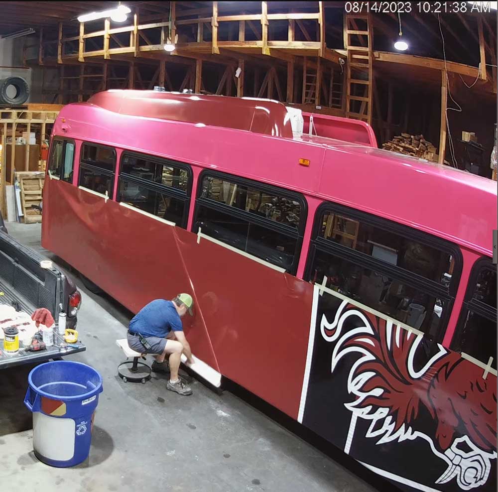

Going to throw this out there, except you can get an amazon one for half the price... IMO the bodyguard is worth the premium, we went from a cheapo one to a few different bodyguards.
You can slit the backing paper in the mid - Tack it onto the vehicle...and theres your hinge, no need to make one out of tape. Sounds lazy....and it is, but its really nice - We use it for pretty much every wall install... Even if its just a 3 FT by 10 FT panel, you bodyguard the top and you have a perfect portion of material to tack to the wall... Align it, press down, let it go and make sure its straight / where you want it, then slowly start peeling the backer away... It makes doing wall alignments sooooo much easier when you're by yourself.
You can get by without it for sure though, but at the price of the tool... it pays for itself the first install.
Once it's taped across the top roll it up, set it on the roof and start peeling the backer about 1-2" end to end, let it roll down and then you can pull the backer without wrinkling and fighting with it.I'd do it that way if it were vertical. The piece is 6 feet wide and I'd find that very difficult to pull down the liner and lay down smooth without stretching or wrinkles.
I think Gino's center hinge sounds like the way to go.

Exactly what I do, pull the whole backer off and pull it taught. The bill collector is the best squeegee...saves your wrist.Depends on the materials and whatnot but this is what I do all the time on buses. This is me rolling the backing off a piece that is 40 feet x 52 inches. Tape the top edge, roll the entire backing off, pull it just a little tight (not enough to stretch it really), let it sit for about 10 minutes and it tightens itself up more, use a Bill Collector squeegee for the large flat areas, then a regular one for the rest.
I wouldn't trust a big squeegee for a trailer or box truck install... even if it had smooth sides.. because there's too much give in between the supports. I have tried it on some large window installs, but even that can be finicky unless the conditions are near perfect.I do this all the time alone. Either way will work fine. If it's not windy I would just center hinge and take all the backing paper off the left side then do the right side. 3' is manageable to hold. If it's windy then do Burtons way.
Out of curiosity, has anyone ever used a Big Squeegee for an install on a trailer if it's smooth sided? I wonder if it would work similar to doing a sign panel?
