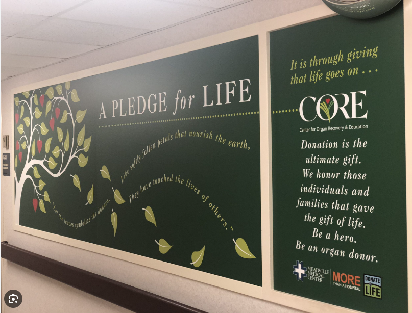

A very good customer sent me a photo of a wall display (see attached) that he saw when he was visiting someone in the hospital and is now inspired to do something similar at his company for a timeline showing their corporate history. The problem for me is the size. From the photo, it looks to be 6-7 ft tall by 12-14 fit wide, and it looks to be one piece. His maintenance staff will handle the installation and framing, but I am limited with my 54" Mimaki as to what I can print without paneling plus the size of what I can mount with my laminator. If I could outsource it reliably and it could be shipped motor freight, I could have it delivered straight to their receiving dock. Any suggestions on how to approach this? THANKS!

It looks like the big sign is 5 1/2 ceiling tiles wide - so maybe 10 ft wide? And maybe there is a panel between the tree graphic and the words? Thanks for getting me to take a closer look at the photo!!

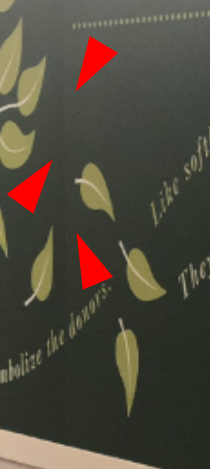

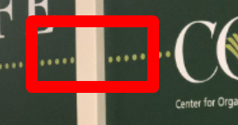

Either a light Shadow or a panel seam with a solid print
If you want "seamless" use a banner with a banner tension frame
PLEASE design so the elements line up....
