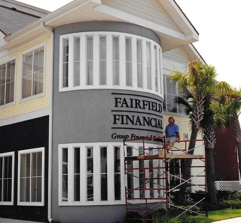

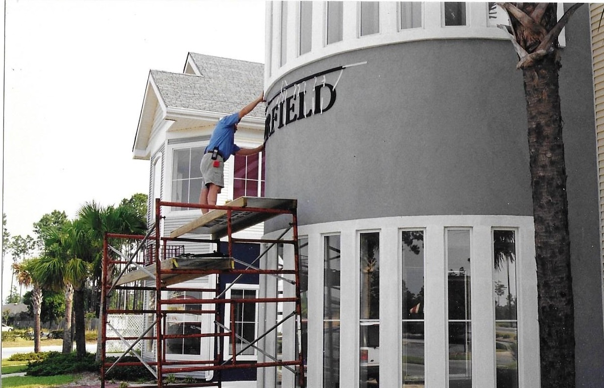

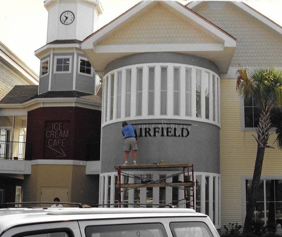

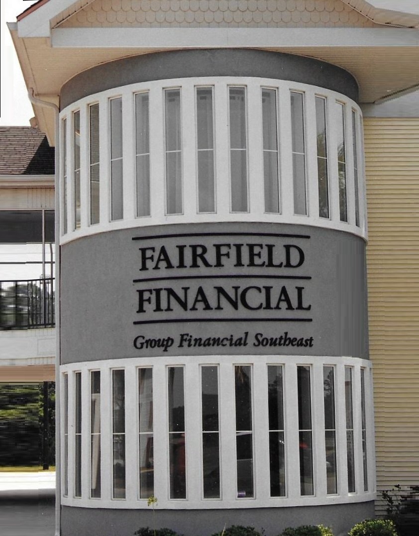

it may not be relevant, but, years ago I had a very similar project. AND - it was on a round surface and the customer did not want "flat" letters on a "round" building and no holes drilled. Being the ingenuitive and imaginative person that I am, I made a profile of the building, made a curved form (caul), rough, oversized cut the letters out of 1/4" HDU, glued two pieces of the HDU together wrapped to the caul, then the next day cut the letters out with a Roto-Zip and processed them accordingly. rented a scaffold, glued the letters flat to the stucco building with 100% GE silicone and called it a day.
15 years later, the company left. the building owner said they had to chisel the silicone off after destroying the letters and the whole face of the building had to be "re floated" with a new stucco finish.
this example may serve as inspiration to someone else some day.
there may be a way - you just need to work with what you've got. (or can get).

Looks real nice, but 15 years ago, the codes might've been a little different. So, when things might work, the codes people need absolutes. Also, you have no safety gear on, which is a total no-no.
However, you did prove my point of using so much schmutz, you did more damage to the building/wall surface, than had you used studs. And your letters are about 1/2 the size the OP is suggesting.

I was referring to the "process" - not the size of the letters.
explore the options with the customer - see what they can "live with" that the O/P can provide and still make a profit.
if the building is flat, even 1/8" thick lexan or plexi weighs much less than 3-D letters and can be flush mounted with an appropriate adhesive.
some jobs just aren't worth the hassle - you just need to know when to say "Sorry, no, I can not help you within these parameters".
Codes Gino ?? that was in South Georgia - I was barely required to have a driver's license. much less safety gear.
and yes, of course, in today's world, everyone should use all the appropriate safety gear for all off-the-ground projects.
