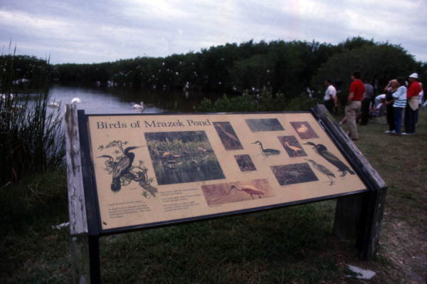

I know there is a two part coating that one can put over signage. A polyurethane maybe? Someone should chime in with what's it's called and who does it.
Who does the informational graphic signs at the state parks and what not?
