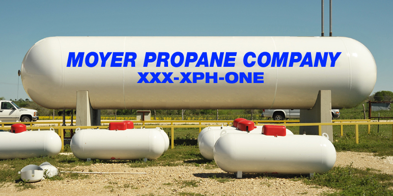

Anyone have experience applying vinyl to a LARGE PROPANE TANK, what is the best material for this application?
Name on tank to be 20" tall and 32 feet long, phone number is 15" tall and 15 feet long.
The tank has been newly painted with epoxy paint, how long should it dry before installing vinyl?
Should I price it the same as a flat sided box truck without rivets?
Thanks for any and all info.

Install will most likely be a breeze...
Ok, however I remember reading a post long ago about problems with propane tanks because the liquid gas inside is colder than the surrounding air temperature. Wanted to know if I need to use a specific material for long term durability?
:help
The liquid is not really at that much different of a temperature. The temperature difference comes during the phase exchange from liquid to gas as the product is released. If the product is removed from this tank in liquid form to be put into another larger truck, the temperature should not change.
The tank will get warmer as Propane is added if added in gaseous form as heat is generated when the gas is compressed into a liquid.
CO2 is the same way and is stored liquid at 700PSI but phase changes and gets cold at the regulator when using it to fill tires etc.. which is popular offroad.
A tank that large is probably filled with liquid Propane, and Transferred to smaller trucks as liquid propane, so the temp should be pretty steady.
graphix45
I would wait at least 2-3 weeks if possible, and use Oracal 751, 951 or whatever brand you use that's comparable. As far as installation, you shouldn't have any problems as long as the paint job is smooth. I did a couple of propane truck tanks with large graphics about 2-1/2 years ago...No problems as of yet.

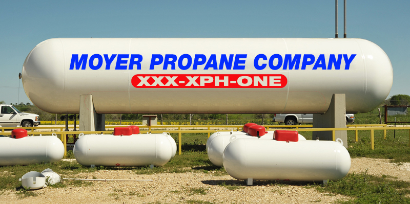

Hey guys, I have one more question regarding this large propane tank job, the phone number will now be a large reverse graphic (see photo below) 15" tall and 18' long.
What is the best way to apply a large reverse graphic this size, can it be done in one piece, wet or dry?

I would hinge it in the middle, soak the tank and the vinyl, apply one side without removing the application tape, remove the masking tape you used for the hinge, then apply the other and finally remove the application tape. Use soapy water to soak the tank.
SlightlyChilled
No one is going to be right up next to this thing. Well no one that matters . Do it in peaces use less vinyl and easy for you to install.
