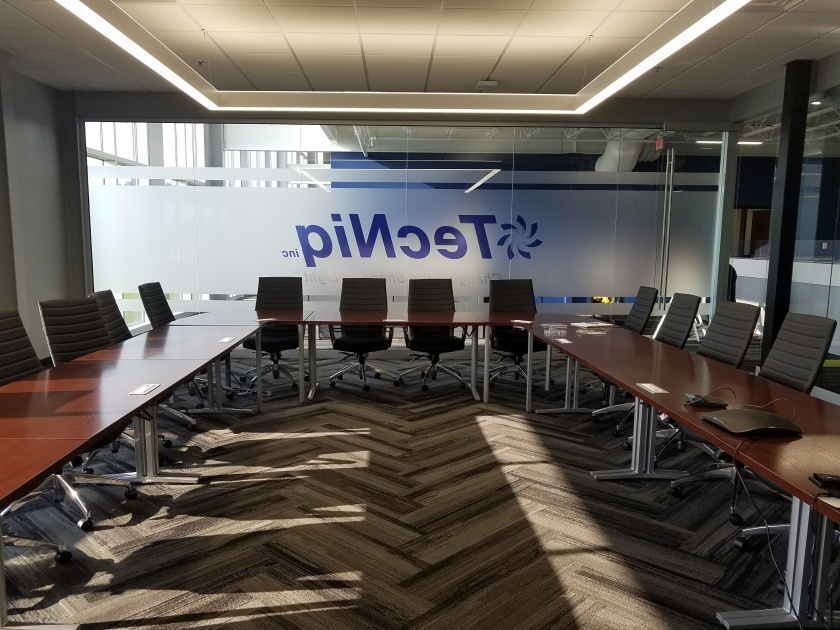

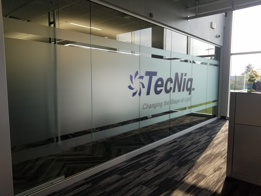

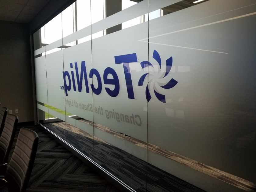

Hey y'all I forgot to update you on this job - it turned out great. I GREATLY appreciate all the help and moral support!

So did you do it in one piece or make the panels to fit the seams of the glass, looks very nice, great job.
Thanks! We ran individual panels, printed and cut 1/2" wider than the glass sections, trimmed after install.
Johnny Best
Well, it looks like you made the right decision on cutting the smaller panels, instead of one large piece, came out nice.
